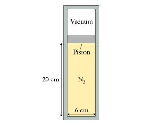

HI! i was wondering if someone could please help me with this physics problem. it looks very simple, and I am only missing one value. thanks
A 6.0-cm-diameter cylinder of nitrogen gas has a 4.0-cm-thick movable copper piston. The cylinder is oriented vertically, as shown in the figure, and the air above the piston is evacuated. When the gas temperature is 20 degree C, the piston floats 20 cm above the bottom of the cylinder.What is the gas pressure?
gas pressure is: p= F/A = (mg)/A(of the cylinder)
my problem is: how can i get the mass of the piston? its really annoying me. please help. thanks

What is the volume and density of the piston? (ie. what is the density of copper?).
AM
thanks for responding!
the density is: 8.96 g/cm^3
the volume of the piston is: [(3.14) x (.03)^2].04 = .000113 m^3 = 113.0973 cm^3
so then, i need to multiply : M= 113.0973 x 8.96 = 1013.35212g
The area of the container is: A= [(3.14 x .03^2)] = .002827
So then: p = Mg/A = 3512858.979
this is wrong though... can you plesae help me find what i did wrong

First of all, work out the solution algebraically and then plug in numbers. Second, you should stick to significant figures.
Mass of piston = [itex]\rho V = \rho\pi r^2h[/itex]
Pressure = Mg/A = [itex]\rho\pi r^2hg/\pi r^2 = \rho hg[/itex]
g = 9.80 m/sec^2
[itex]\rho = 8.96 g/cm^3 = 8.96 x 10^-3 kg/10^{-6} m^3=8.96 x 10^3 kg/m^3[/itex]
Pressure = 8960 x .04 (9.80) = 3512 N/m^2 = 3512 Pa. = 3.512 kpa
In significant figures, this would be 3.5 kpa
