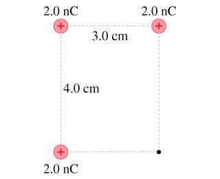

There is a 4 cm by 3 cm rectangle with 2.0 nC charges at three corners. I'm trying to find the electric potential of the last corner in V.
U=(kQq)/r I think
V=(kq)/r I think
I found the U's between the know corners but i don't know where to go from there.

Aww, sorry for the mistake, There is no electric potential in the 4th corner, because there is no charge there, However you can calculate the voltage there (V) .
oh... thank you.
Apparently there is because I typed in 0 and the program said I was wrong.
It wants the V for that point, so where would I go from having the U's of those adjacent to it?
Then, by electric potential he mean V (voltage), no charge means no electric potential energy (by intuition and the formula insists on that), however, calculate the voltage out there :)
How would i go from U to V? What U would I use?
You can't go from U to V, because there'there's no charge out there, but one thing you can do is use V = kQ/R
[Edit: you can't because you'll be dividing by zero, moreover U = 0]
What Q and what R?Would i use the average?
R is the distance to the 4th coner, Q is the charge at each corner.
Calculate the potential due to each charge and sum them up !
