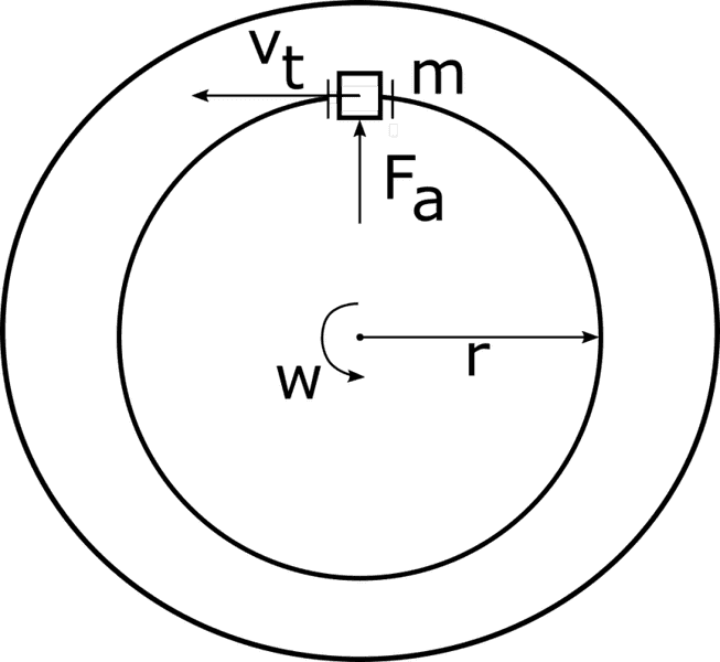

Hello,
i want to determine the velocity with which an object moves after it has departed a rotating disk. In my problem there is a disk rotating with the angular speed w. On this disk there is a drilling in which a mass m is positioned. In case the thread in the drilling fails i need to determine the velocity with which this mass hits the housing. During the rotation there is a force F_a additionally to the centrifugal force. My idea is to determine the tangential velocity with v_t=rw and with F=ma i can determine the acceleration due to the force F_a. Do i need to determine another accelerations or velocities. I am doing a rough calculation therefore the calculation doesn't need to consider all possible effects. I inserted a scetch of the problem. I would very welcome some help. thanks
Does F_a still act after the mass is released? If not, then the mass will hit the housing with the tangential speed it had on release (ignoring air resistance etc.). What might be relevant for the damage to the housing is the impact angle, which depends on the radii of disc and housing.

@A.T. No F_a doesn't really act after the mass is released but i think it does partially. This force comes from an oil pressure which means that some force will still act after release. The impact angle isn't very interesting at this point. But i don't really understand why it will only hit with the tangential speed, what about the force F_a ? In the very first moment it will surely accelerate the mass , wouldn't it ? And doesn't the centrigual force contribute to some radial acceleration ? i have added a scetch. a_a means the acceleration due to the Force F_a . a_r comes from the rotation.
You have to make up your mind here.
dogge76 said:
And doesn't the centrigual force contribute to some radial acceleration ?.
If you analyse it from the inertial frame, there is no centrifugal force.
No F_a won't act after the mass is released
