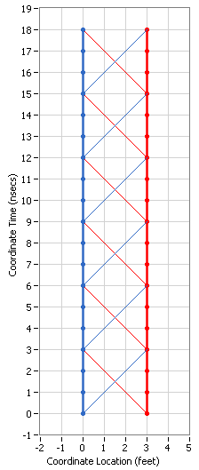

You mentioned earlier a light box so that's what I'll use for my example. Consider a box with two mirrors on opposite sides spaced 3 feet apart. We start two photons (or flashes of light) going back and forth between the mirrors such that they cross paths in the middle of the box. Then we draw a spacetime diagram to depict this scenario:
Hopefully this diagram makes sense to you. The dots represent 1-nanosecond increments of time along the two worldlines for the ends of the box where the mirrors are. Each dot is a separate "event" with its own x and t coordinates. (It also has y and z coordinates but we set them equal to zero and they remain zero even after transformation.) Note that since the light travels at 1 foot per nanosecond, it follows the thin lines drawn at 45-degree angles.
Also note that an observer at the blue end of the box can only see what is going at x=0. So he can see that a flash of light reflects off his mirror every 3 nanoseconds. And since he knows that there are two flashes of light, he knows that it takes 3 nanoseconds for each flash to make the round trip. And since he defines the speed of light to be 1 foot per nanosecond in his rest frame, he declares that the two flashes of light hit the opposite mirrors at the same time, in other words simultaneously, although he cannot see this happening. That's what we show in the diagram. Every 3 nanoseconds, there is a flash of light reflecting off of each mirror.
Now we transform from the blue observer's rest frame to one that is moving at -0.6c. This will make it look like the light box is moving to the right at 0.6c:
Now, all of a sudden, we see Time Dilation, Length Contraction and Relativity of Simultaneity. But first, let's make sure you know how the LT works. Pick any dot. Let's start with the blue one at the top. It's coordinates are x=0 and t=18 in the original frame. So we plug those numbers into the LT equations, one at a time:
x' = γ(x-βt) = 1.25(0-0.6*18) = 1.25(0.6*18) = 13.5
t' = γ(t-βx) = 1.25(18-0.6*0) = 1.25(18) = 22.5
As you can see on the transformed diagram, the top blue dot has coordinates matching those values. You can continue with all the other dots. Or you can cheat and just do it for the top two and bottom two dots and then just fill in the remaining dots by proportionally spacing them.
