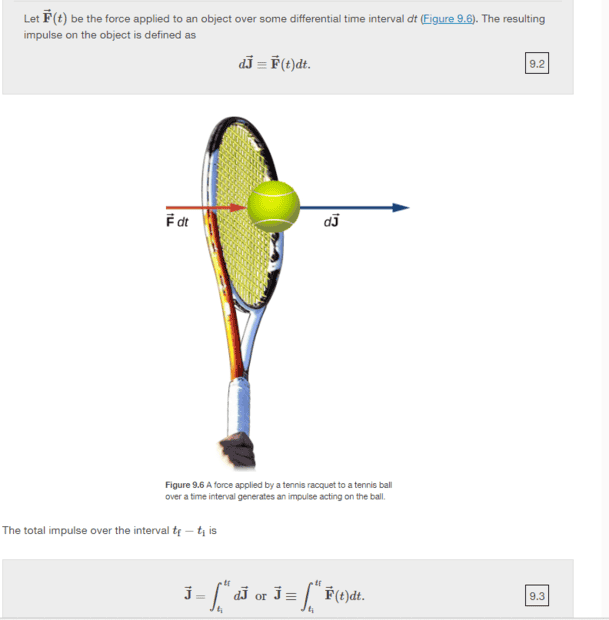

Can someone please tell me why they integrate the impulse over from ##t_i## to ##t_f##? Why not from ##j_i## to ##j_f##? It seems strange integrating impulse with respect to time.
Many thanks!

If you are using
##\displaystyle \int d \textbf{J}##
and you have the ##\textbf{J}##'s at the endpoints, the use the ##\textbf{J}##'s.
If you don't have the ##\textbf{J}##'s then you need to use
##\displaystyle \int \textbf{F}(t) \, dt##
-Dan

If you think of ##\vec J## as the cumulative impulse given over some period of time then ##\vec J=\vec J(t)## and it is reasonable to write ##\int_{t=t_i}^{t_f}d\vec J(t)##. But omitting the "t=" from the bounds is a bit naughty.

Thank you for your reply @topsquark and @haruspex!
@haruspex, now that you say J is a function of t I think that helps.
Many thanks!
