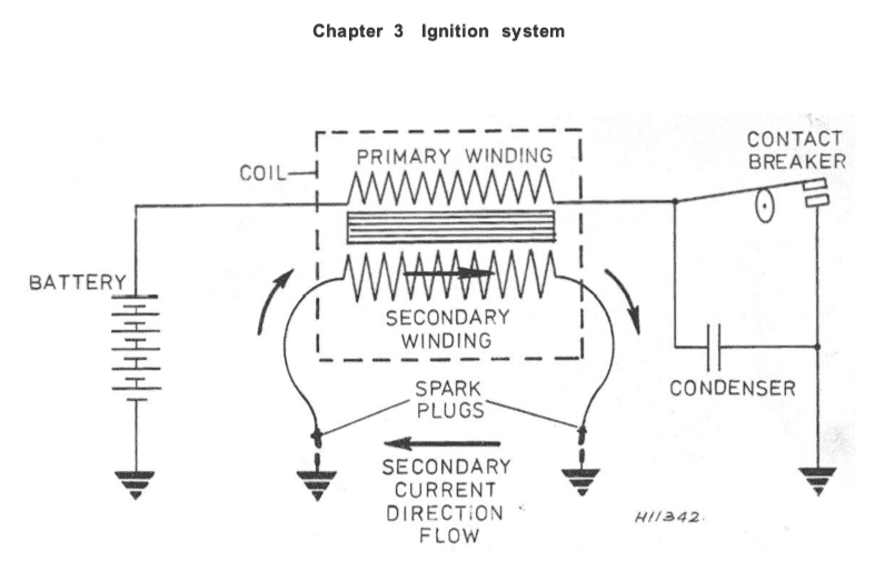

As I get it is that after the contact breaker breaks the contact then the current flows from plus of the battery through the primary winding then through the capacitor and to the minus of the battery. But then what happens to the secondary current? It goes from secondary coil and then what? Does it go through capacitor? Does it go back through primary winding to the plus of the battery? I don't get it.
not quite, the capacitor is only for RF noise suppression. If you removed the capacitor, the system would still work, except that there would be lots of noise on AM radio in particular.
So it rather goes down via the contact breaker to ground ( negative). This pulsing voltage in the primary winding of the coil induces a voltage into the secondary winding. A much higher voltage is produced because of the turns ration of the pri. and sec. of the coil giving around 25 kV to each of the sparkplugs in the appropriate firing order via the distributer
That's about the easiest description :smile:

True enough about lots of RF without the capacitor, but it isn't the whole story. Years ago my Datsun B-210 died suddenly, and produced a very weak spark when turned over. Lifted the condenser lead, and got it running (cap must have shorted), but it ran like crap, and nearly ate up the points in the twenty mile drive home. Part of what the capacitor does is reduce arcing across the points, which (in addition to reducing RFI) prevents them from failing prematurely, and (by not dissipating energy in the point gap) frees it to do useful work across the spark plug gap.
Indeed that capacitor is the secret to this type of ignition.
The capacitor provides a current path around the points for that brief instant when they first open.
Almost immediately the coil voltage at points rises to a high value, like a couple hundred volts,
because coil's inductance is now trying to push the current that got established while points were closed through the capacitor instead.
The capacitor slows that voltage rise just enough for the points to move apart a few thousandths of an inch without forming an arc.
Since the coil is really a step-up transformer,
a much much higher voltage appears at its secondary
and that's the voltage they send on to the distributor and plugs.
Without the capacitor a set of points will last less than an hour,
and the engine will run progressively worse as the points burn away from the arcing.

Would this autotransformer configuration reduce stress on the winding insulation, and save a bit of copper?
Apparently the newer-type coil packs have separate windings. I guess that modern electronic ignition systems appreciate proper isolation between primary and secondary.
The transformer has a ratio of perhaps 30:1 so that is not the whole story, as it gives 25kV from a 12V battery. It is the rate of change of current in the primary, which creates such a high voltage. V = -L dI/dt. The capacitor speeds up the rate of change.
Indeed it's di/dt that causes high voltage in both the LV and HV windings.
Current can't drop to zero immediately for that would make infinite voltage(were the coil a perfect inductor)
and without a capacitor the voltage rises so fast that it establishes an arc across the points before they've moved far enough to make a decent air gap.
That's why @Asymptotic's anecdote is so relevant.
Adding a capacitor let's flow of current continue, into the capacitor instead of through the points,
giving the points time to separate far enough they'll withstand a couple hundred volts.
Last car condenser i measured was 0.2 microfarads (my kids' 65 Buick)
and coil current was set to ~2 amps by the ballast resistor.
Now,
pumping 2 amps into 0.2 μF raises voltage by 10 volts per microsecond (##~i = c\frac{dv}{dt}~## )
giving the points a fraction of a milisecond to establish a small air gap before voltage across them rises high enough to strike an arc.
Dielectric strength of air is maybe 75 volts per mil (3 megavots per meter https://hypertextbook.com/facts/2000/AliceHong.shtml )
and perhaps 30 to 40 megavolts per meter at very small gaps, see Paschen's Law
so using the lesser dielectric strength
a point gap of 0.018" should hold off at least 1350 volts
which with a 30::1 step up could hand 40kv to the sparkplug.
A plug with gap of 0.030 should require less than that to fire.
New CD systems charge a capacitor to high voltage (400 volts in Evinrude outboard motors I've worked on)
and connect that across the primary of a stepup transformer 'coilpack' .
They'll make higher voltage than these old systems we're discussing
and that's why new engines keep running when the spark plug electrode wears away and plug gap exceeds a hundred mils.
my observations - corrections welcome.

No one has mentioned that the primary circuit (with capacitor) is a high Q tank (series RLC) circuit that rings like a bell when the points open. I think this is a major design feature that allows a series of AC pulses be delivered to the plug when the circuit gets "hit" . I remember being astounded by what a nice oscillation actually ensues.

There seem to be a couple of points missing in this thread - or perhaps I missed them. The value of the "Condenser" (as it was called, years after the accepted term was Capacitor) is chosen to maximise the rate of change of current in the primary the the contact breaker opens - it's a Tuned circuit. That gives as high secondary Volts as possible. Also, I seem to remember that the series connection of the Primary and Secondary windings was to add the primary Volts to the Secondary Volts when applied to the plugs.
Some early systems used a Positive Earth (The 6V Ford Popular electrics, for example). I'm not sure why but it was something to do with the feeble spark and the need to give the plugs the best chance of actually lighting the fuel so the polarity was chosen appropriately.
Something that not many people know is that the Citroen 2CV ignition system had two cylinders and no distributor. The Coil Secondary was connected in series with both plugs (and HT lead from each end of it). Every rotation of the engine applied a spark to both (series) plugs. The plug in the 'Exhausted' cylinder would strike easily with very small Volts drop because the pressure was low and the plug that was under pressure hogged nearly all the EHT Volts. I guess it meant fewer moving parts in an already simple engine. The contact breaker was on the end of the crankshaft (with centrifugal advance weights) but there was no vacuum advance - but hell, it wasn't Formula One'
241027
Note the 12V battery which was only on 'later' models! I seem to remember that one plug consistently used to fail before the other, due to the different polarity. There were many lunatic features on the loveable little car. The ignition coil was positioned right where the rain could get in, just over the (Air Cooling) fan intake. WD40 was frequently needed.
