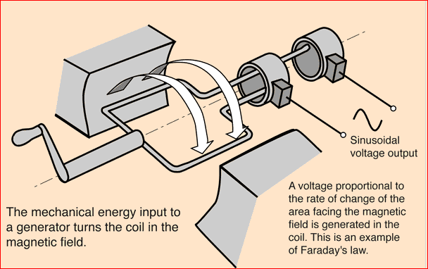

I'm lightly studying 'Generating' as a topic in my Physics curriculum. I have just been introduced to an AC Generator, an Alternator, and I have a simple question: Is the armature in an alternator an electromagnet?
From my understanding, there is a U-Shaped length of wire(s) which rotates, generating a current (in a generator). This then produces an AC current in the stator coils surrounding. I believe the U-shaped rotating piece is the armature. I have been confused by the multiple interpretations of an AC generator, and do not have access to one myself. Could someone please explain this to me. Some say an iron core (nail) in a solenoid, whilst others show the familiar U-Shape I have seen in online motor demonstrations.

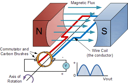

So the armature in an alternator is an electromagnet? This rotating electromagnet is a rotor? And the electromagnet is surrounded by a radial field from the two poles of a permanent magnet?
In regard to the shape, does that mean that the u-shaped coil (shown below) would be a solid iron piece wrapped in copper wires to make it an electromagnet?

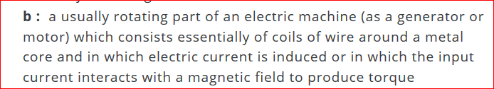

There's some finesse in the definition of "armature"
Webster:
Your picture in post 4 is not an alternator , it's a DC generator.
Note the commutator rectified the voltage that got induced into the moving armature wires. Most DC machines are built that way, with a segmented commutator.
Yes the u-shaped coil(s) wrap around an iron core.
But not to make it an electromagnet.
The iron core allows the field, which is in that picture the permanent magnets, to push more magnetic flux through the region where armature conductors are spinning.
That way the armature conductors have induced in them more voltage because e=BLv and flux is B.

No. The armature in any rotating machine is the winding where the magnetic flux from the field induces voltage.
That's where the electro-mechanical energy conversion occurs.
That can be either the rotating part or the stationary part.

Here is an alternator, from http://hyperphysics.phy-astr.gsu.edu/hbase/magnetic/motorac.html:
Note that the slip rings are not segmented so you get AC out not DC. That's the difference between a simple alternator and a DC machine, the commutator.
In this pink & gray picture just above the alternator's armature rotates just as in a commutated machine.

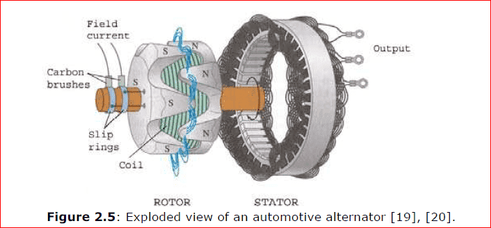

Observe the rotating part is not an electromagnet.Most alternators are built the other way, armature stationary and field rotating for a practical reason.
The field rotates and the armature , being in the stator, is stationary.
Observe the rotating part IS an electromagnet. But it's the field.
With this design your slip rings need only be big enough to handle a few amps of field current, not the hundred amps from armature.
And they needn't be segmented which saves a lot of machining. Time is money...
Take apart a junk car alternator and study it. It is a three phase synchronous alternator. Usually all they need to restore them to operation is brushes and a front bearing.
Here's a master's thesis on car alternators for wind turbines , i thought it might be interesting to you:
repository.tudelft.nl/assets/uuid:60a3ca0e-25f0-4892-ae52-300dcb4443ab/MSc_Thesis_Application_of_automotive_alternators_in_small_wind_turbines.pdf
it's where i got that fig 2.5

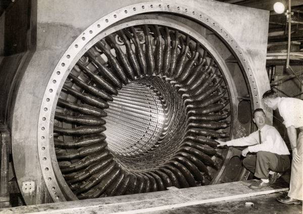

Here is a picture of a medium sized real alternator.
You can see the u-shaped armature turns in the stator.
They run through slots in the core.
The field (rotor) fits in the round hole at center. It carries u-shaped turns that magnetize it.
Here's a picture of one, probably not from this exact machine though.
So the "Core" really is the whole magnetic path consisting of both the rotor and stator iron.
We sometimes mis-use the term to mean just the stator, though.

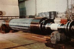

This would be a cross section of the rotor
u-shaped turns lie in the machined slots , well braced braced so centrifugal force doesn't sling them out.
Use your right hand rule to see that magnetic flux is indeed up as shown in the sketch.
each slot contains several turns , on purpose not all the same so as to produce sine wave voltage at generator terminals.
That "Flux Probe" on left is used to monitor flux at each rotor slot as the rotor spins by
a slot with a shorted turn in it will show less than its fair share of magnetic flux.
Shorted rotor turns are difficult to find because they usually disappear when the machine is stopped and the conductors are no longer pushed together by centrifugal force. You have to find them when machine is at speed. They cause vibration that changes with vars(see Anorlunda's insights) because of magnetic unbalance.

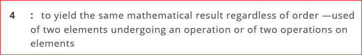

slip rings are slip rings and commutators are commutators. Remember "Commutate" has a mathematical meaning.

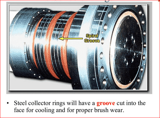

Here's a fair sized slip ring
but no segments - it doesn't commutate.
Picture came from that slideshow linked above
