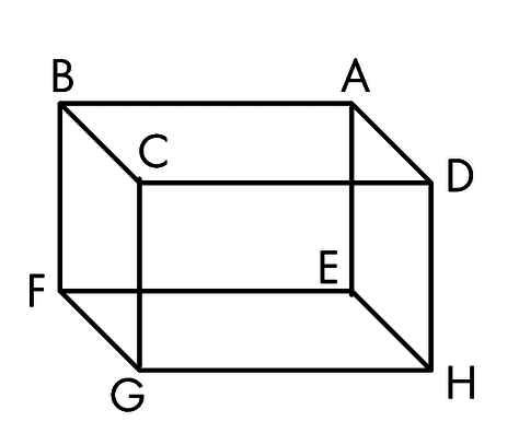

Twelve resistors of equal resistance are connected so as to form a
cube ABCDEFGH shown. Equivalent resistance between points A
and G is 5/3 ohm. If a battery of voltage 100 V is connected across
the points A and G, find the current (in ampere) flowing through the
resistor CD.

So 100=i*5/3 ( between A and G )
So current between A and G is i=60 .
But what now ? How to calculate current between C and D ?
Use the symmetry and use KCL. I=60A current flows into A. It has three equivalent ways to flow: Towards B, D, and E.
The current flowing into D has two choices to flow further...ehild

It is not needed. You are given the equivalent resistance. So you know the current flowing into the node A. How much current flows out of A along each resistor connected to A?
ehild
Follow Echild's advice. 60 amps flow out of node G and 60 amps flows into node A. By symmetry, the current flowing out of node G splits evenly between legs GH, GC, and GF. Also, by symmetry, the same 60 amp current converges evenly from BA, DA, and EA into node A. So, the current in all 6 of these legs is 20 amps. Now all you need to do is to use symmetry to figure out how the 20 amp current coming into node C from node G splits between legs CB and CD.

So the current splits evenly between CB and CD and so the current through CD is 10 amps . The answer is right but can you link me to a good online video/tutorial/guide/book which explains this "symmetry " thing ?

Take the 1st corner, draw a shorting plane through the vertices of the adjacent corners. Do the same at the diagonally opposite corner. What is the net resistance. If one corner is A, the other G, we compute Rag as follows. From A to plane 1 we have 3 edges in parallel for 1/3 ohm. From plane 1 to plane 2 we have 6 edges in parallel for 1/6 ohm. Then from plane 2 to G we have 3 edges in parallel for 1/3 ohm.
Rag = (1/3) + (1/6) + (1/3) = 5/6 ohm.

Just for the record, in that scenario, the R value for each edge would be 2.00 ohms. Then 5/6 of 2.00, gives 10/6 ohm, or equivalently 5/3 ohm.
