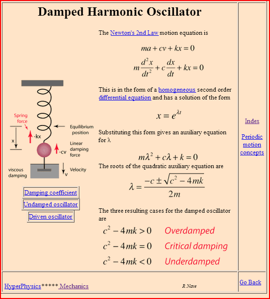

Like in damping of harmonic oscillations.
What do the overall dimensions of the quantity in the exponent need to be? So what does that tell you about the dimensions of λ ?

No worries. The post number in each thread is shown in the upper right of each post. This post of mine will likely be #17, since I'm replying to your post #16. So just scroll up the thread to look for my reply in post #10. It was a post showing some equations from Hyperphysics to help you see the typical differential equation and solution for a damped harmonic oscillator. :smile:

Like in the Hyperphysics equations? Sure. Can you show the dimensions for each of the terms in the initial differential equation? And then show how that helps to define the dimensions of λ in the end?

Okay, but what are the dimensions (or units) for each of the terms in these equations?
VVS2000 said:
I think I can. I can show the complimentary function for x. Then I can By eliminating the constants by plugging in the initial conditions, we can find the dimensions of lambda
The dimensions of c are...?
The dimensions of m are...?
The dimensions of ##\lambda## are...?
The dimensiona of lambda is (time)^-1, time inverse, basically frequency. .M is mass. That is given. I don't or I am not quite sure on c
The starting equation contains forces. What are the units of force in mks? Each term has to have those same units, right? That helps you figure out the units for the other terms that introduced in the later equations. And yes, since λt is in the exponent, and since the exponent needs to be dimensionless, the units of λ need to be 1/s.

Yeah ok so c has units of M(T)^-1

That’s correct.
