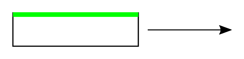

Ok I'll try to articulate myself better, and I do appreciate your patience here.
In the image below, the speaker is depicted as moving rightwards at a uniform velocity (v), relative to a stationary observer. Also assume that the air is stationary.
The green line indicates the membrane of the speaker.
Suppose that at some point during its motion the membrane is driven upwards very fast by a tiny amount. It does not return to its original position, so it creates a single wave of compression in the air molecules directly above it.
I'm having trouble understanding why this wave of compression propagates at an angle, relative to the stationary observer.
Oh, wait, something just occurred to me.
The movement of the membrane is actually diagonal, just like you explained earlier:
