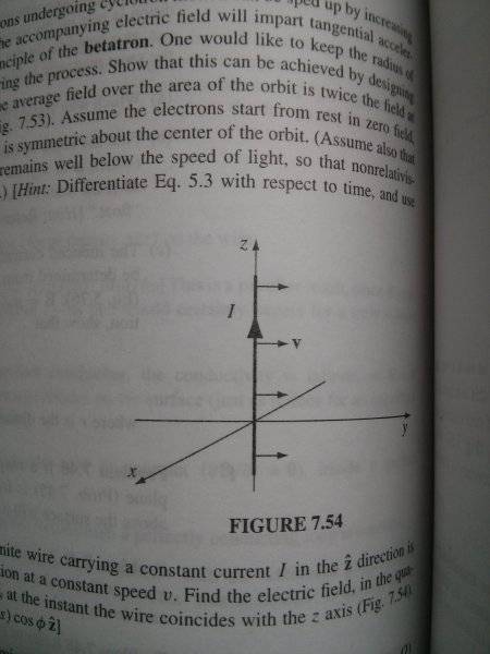

An infinite wire carrying a constant current ##I## in the ##\hat{z}## direction is moving in the ##y## direction at a constant speed ##v##. Find the electric field, in the quasistatic approximation, at the instant the wire coincides with the ##z## axis. [Answer: ##-(\mu_0Iv/2\pi s)\sin\phi\hat{z}##]
[In griffiths' book, the answer given is also shown right at the end of the problem and is wrong - it says ##\cos\phi## instead of ##\sin\phi## according to the official errata list]

EDIT: I attached the figure corresponding to this problem to help visualize this one.
  • Figure 7.54: a vertical wire along the z-axis with current I pointing up and velocity v pointing in the y direction, with x and y axes and arrows indicating the magnetic field circling the wire.
You want to find the electric field at some fixed point (x, y, z) in space at the specific time, t0, when the wire is coincident with the z-axis.
Thus, you want ##\vec{E}(x, y,z, t_0) = -\left[\frac{\partial \vec{A}(x,y,z,t)}{\partial t} \right]_{t=t_0}##.
x, y, and z have fixed values in ##\vec{A}(x,y,z,t)## inside the bracket. Only t is changing.
Can you express the distance ##s## between the fixed point and the wire in terms of the fixed values of x and y, the speed v of the wire, and the time variable t? For convenience, you can assume that the time at which the wire is coincident with the z-axis is t0 = 0.

The position of the wire is ##s'=vt\hat{y}## (If at time ##t=0## it coincided with the z-axis), the position of the arbitrary point is ##s=x\hat{x}+y\hat{y}## (I neglect the z-coordinate as it is irrelevant to the distance between the point and the infinite wire). therefore the distance between them is ##|s-s'| = \sqrt{x^2+(y-vt)^2}##. Then, ##\vec{E} = -\frac{\partial\vec{A}}{\partial t} = \frac{\mu_0I}{2\pi}\frac{\partial\ln s}{\partial t}\hat{z} = \frac{\mu_0I}{2\pi}\frac{\partial\ln s}{\partial s}\frac{\partial s}{\partial t}\hat{z} = \frac{\mu_0I}{2\pi s}\frac{\partial \sqrt{x^2+(y-vt)^2}}{\partial t}\hat{z} = \frac{\mu_0I}{2\pi s}\frac{(-v)(y-vt)}{\sqrt{x^2+(y-vt)^2}}\hat{z} = -\frac{\mu_0Iv}{2\pi s}\sin\phi\hat{z}## where, by trigonometry, ##\sin\phi = \frac{y-vt}{\sqrt{x^2+(y-vt)^2}}##.
Thanks you very much, I like this argument - more straightforward. (Although I think that it is identical to mine above - here the equations are identical to the case where the arbitrary point moves with velocity ##\vec{v}=-v\hat{y}##, right? In either case I should have been more rigorous).
That looks very good.
Yes, moving the point in the opposite direction while keeping the wire fixed will yield the same result for ##\frac{\partial s}{\partial t}##.
