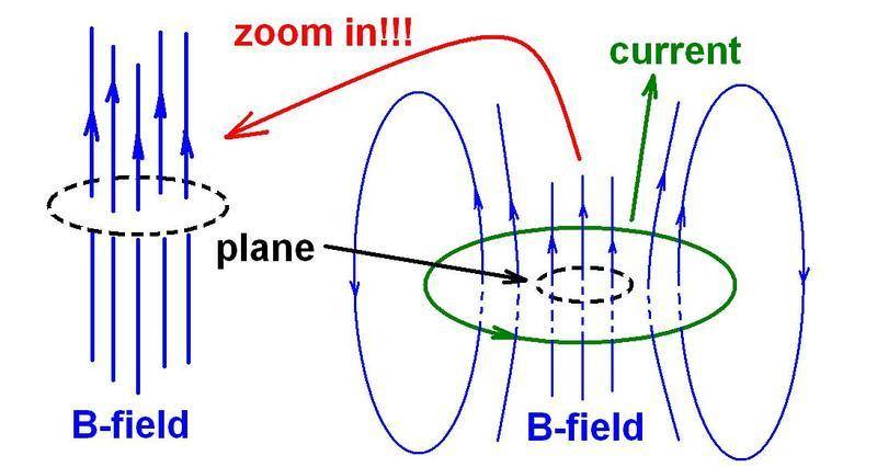

If a time varying magnetic field of infinite dimensions crosses a plane at right angles what can we expect induced electric field lines to look like? Straight lines with direction determined by the right hand rule?
No.
The induced electric field forms a vortex (concentric circular loops).
Its direction is determined by right hand grip rule.
And what will the center of such a vortex be?[The question was asked keeping this very fact in mind]
No, the question was asked thinking about electric field lines to be straight :biggrin:
The plane is infinite and so is the magnetic field. You can arbitrarily take any point as the centre.
That does not uniquely fix the direction of field at any point----an essential condition for any vector field.
Offcourse it does. Fix a centre of the vortex - it will be the geometric centre if the plane is finite. But if its infinite - it can be assigned arbitrarily. After this step, the direction of field at any point is uniquely defined - tangential to the line joining the centre and the point.
I don't understand------if your first step does not uniquely define the centre of vortex how do you expect the second step to? Consider this---the centre can lie anywhere and hence the field can have any direction at that point------yes it is wrong and makes no sense. I can not simply say any direction because the direction will always be unique no matter what and any contradiction of this fact is a definite indicator of flawed logic.
The problem here is that the plane is infinite. In this case it is same like fixing a co-ordinate system with an arbitrarily located origin and then doing vector algebra w.r.t. this origin which was arbitrarily fixed. Now will you say that the centre (origin) can lie anywhere in the plane and hence any vector under consideration can have any direction (w.r.t. the origin)?
If you have a better solution then let me know :wink:
I'm not sure how the B-field looks like, but you may want to consider the picture :wink:
A plane is infinite. You cannot make it finite (keeping the closed loops around the plane in mind) :biggrin: . The B-field is just perpendicular to the plane everywhere (thats how I interpret the question).

We have situations like this- an infinitely long current carrying wire. Where does the source of driving this infinite charge come from? Is it not a violation?
The OP's latest question was regarding the logic in fixing a centre. I rechecked your picture and found that you too arbitrarily fixed a centre in the plane.
The term "infinitely long" straight wire in particular (and "very large setup" in general) is normally used in the meaning that we consider the phenomenon locally: we don't look at the field at the end of the wire. The wire cannot be infinitely long in the meaning that it is truly infinite. This is what I'm trying to say by the picture. If you are alone in a desert, things would look like to you that you would never get out of it; but you can if lucky enough, right? :biggrin: Similarly, if you look at the space locally, it would look like to you that the setup is infinite and the field is just the same at every other points in the space, but they are actually not.
The emphasis of the picture is on the current source. This is where the center comes from. The imaginary plane has nothing to do with the center of the field. The shape of the field depends on the source, and thus, since the source is finite, that constraints the field in a sense that there is a center.
How will you define a magnetic field of infinite dimensions (given in the question) from a finite source?

Look at the picture. The B-field has closed field lines. At some point, B points upwards; but at some other points, B points downwards. It is the nature of the field.
By the way, you may want to prove that uniform infinite B-field doesn't exist in the constraint of finite source, say, a current source. Hint: Apply Ampere Law at the current.
B-field is inherently infinite (in the extent of classical physics). It's just that it must have a determined center - that's the point.
