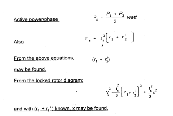

For the locked rotor test I have these values,
P1 = 620W
Stator line voltage = 32V
Stator line current = 8.4A
To calculate active power/phase,
Po = (P1+P2)/3
But I don't have P2, Is P1 maybe equal to P2 ?

By the way, what I am actually trying to calculate is r1+r2' and X, given by this equivalent circuit

Good one ! I missed that, admittedly i didn't try out your numbers...
So we have an impossible result , a wattmeter reporting power factor over unity (the free energy crowd will love that !)
Therefore we must question our observations and root out what mistake(s) led us into that impossible conclusion ?
P1 reported 620 watts with 32 volts and 8.4 amps - something looks fishy there.
I note you show a CT but no PT(voltage stepdown transformer)
Look at the back of PI . Does it assume any PT ratio and CT ratios?
or Is full scale on P1 equal to 5A X 400V = 2000 Watts ?
If the latter, P1 will under-report power by the CT ratio
With CT set on 10::5 , 1240 watts would report as 620
with CT set on 20::5 , it'd take 2480 to report as 620
