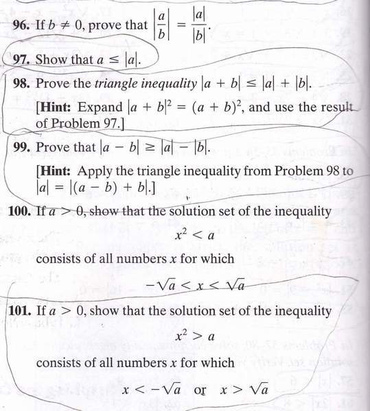

attached are the problems (actually i don't think i bothered with #96) I'm having trouble with.
attached is ONE of my attempts
and attached is the book's answers.
I have NO idea where to even begin with these.

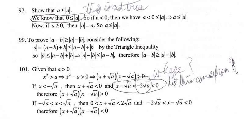

For 97, you have a note for 0 <= |a| that says this is not true. It most certainly is true.
For 101, where you have a question, the assumption is that x < -sqrt(a), so x + sqrt(a) < 0.
So x - sqrt(a) < -sqrt(a) - sqrt(a) = -2sqrt(a) < 0. This shows that x - sqrt(a) < 0.
Now, since x + sqrt(a) < 0, as well, the product (x - sqrt(a))(x + sqrt(a)) > 0, since both factors are negative.

You are misreading the inequality in two ways. The inequality 0 <= |a| says
1) |a| is greater than[/color] 0 (not less than, as you wrote).
OR[/color] (not "and", as you wrote).
2) |a| is equal to zero

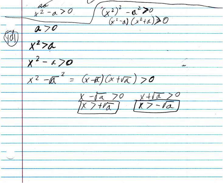

this is what i got for 101. i can't seem to get one of the inequality symbols to turn the right direction. what did i do wrong?
It would be easier if put your work here in text, rather than as a screen shot.
To comment on your work I have to use two screens, and switch back and forth between the two.
Where you have
you have two factors whose product is positive. For the sake of simpliciy, let's call them M and N.
If M*N > 0, then one of two things must be true:
1) M > 0 AND N > 0. (For example, (2)(6) = 12 > 0)
OR
2) M < 0 AND N < 0. (For example, (-2)(-6) = 12 > 0)
After this line -
your work should include two cases, one where both factors are positive, and the other where both factors are negative.

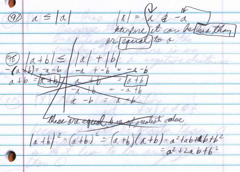

can we start this again with problem 97 and go in order through each problem? they are dependent on each other.
this is my new answer for number 97
Again, it would be helpful if you posted your work directly on this page rather than a screen shot. As already mentioned, anyone helping needs to keep track of two screens. For another thing, to comment on your work, I have to type it, too, in addition to comments I make.
If you want help, don't make it more difficult for someone to give you help.
In the work you posted, there are several things that aren't true.
You wrote 0 <= |a|. This is true by definition. Your reason is incorrect, though.
"because a must be a positive value" - a can be any real number. |a| can be either 0 or positive, but it can't be negative.
"if absolute value of a is on the negative side ..." - |a| is never negative.
"if it is on the positive side the (sic) a is = to a" -- Any number is always equal to itself. What's the point of saying this?

the problem is to prove a < or = to |a|
a can be a or -a but |a| is always going to be the positive of those two as it is the distance that is counted in the case of |a| and not the actual value. the point is to show that the a in |a| can be a or -a. so a is less than or equal to |a|. I'm not sure that's a proof but it is a given point of the definition i believe.
if this explanation is a correct solution to the problem then please show me number 98. if not then please critique it and the next problem too.
98) prove that |a+b| less than or equal to |a|+|b|
they give a hint to expand "|a+b|^2 = (a+b)^2" for some reason that i am not capable of understanding at the moment.
