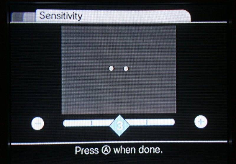

BTW, what are the consequences of getting it wrong? Is there human confirmation before firing up the 1.4GW laser?But I still say you're better off with IR sensors. If they're cheap enough to go in a Wii, then you should be able to use them for your purposes.
And rather than range-finding techniques, you could use angle. Have you ever seen the "image" that the Wii bar sees? It tracks the controller movement in a 2D plane.

Thank you all. I will investigate the Wii sensor and also the GPS solution. As noted by Dave, I am looking for an inexpensive and unobtrusive solution. In the USA we us a variety of methods to align patients including optical tracking, IR tracking, stereotactic localization, and electromagnetic beacons. The gold standard is x-ray imaging which confirms proper alignment and is used widely. In developing countries most of these solutions are unavailable and alignment is based on external marks which are aligned to fixed external lasers using a 3 point system. This system is not always robust and provides very little feedback to help align the patient correctly. My purpose is to develop something to aid the laser alignment and improve accuracy.
