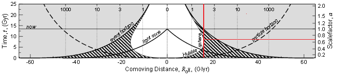

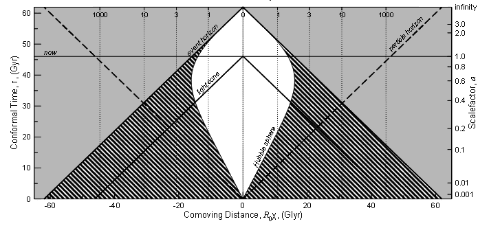

Take a look at the spacetime diagram from the L&D paper:
At present, the distance to the event horizon (where it intersects with the 'now' line) is 17.3 Gly. This means that, as you say, light emitted from those galaxies will eventually reach us at t=∞, while nothing beyond ever will.
However, the even horizon extends to our past as well. Light signals that were emitted in the past whose lightcones lie within the event horizon will also reach us.
For example, if you look at light emitted at recombination by objects that are now at 63 Gly, their light will be now passing the 17.3 Gly point marking the present event horizon distance, will join the light emitted there presently, and reach us at infinity.

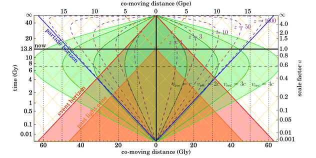

I've found this version of the above graph at physics.stackexchange:
It's got the advantage of using a time scale more intuitive for non-cosmologists, and including lines of constant recession velocity.
More details here: http://physics.stackexchange.com/questions/60519/can-space-expand-with-unlimited-speed
One can trace a signal emitted at any time in the past, and observe how it passes the consecutive regions of superluminal recession rates.
Keep in mind that both graphs use co-moving distances, so the object presently at 63 Gly whose light we'll be able to observe at t=∞ emitted the signal at much closer proper distance (at the time) and will have receeded rather quite farther than that (∞) by the time it reaches us.

Since the event horizon in time becomes equivalent to the Hubble sphere, the ability of the observers in the far future to see non-locally bound galaxies can be estimated based on whether or not galaxies stay within the Hubble sphere as the universe evolves.
If we now look at the spacetime graph:
we can see that at the moment of beginning of acceleration (thin horizontal red line) there was the maximum number of galaxies lying within the Hubble sphere (vertical red line - each of the comoving distance vertical lines we may draw on the graph, starting at the origin, is equivalent to the worldlines of consecutively farther galaxies).
Up to that point, galaxies were crossing the Hubble sphere from the 'outside'. From that point on, they are crossing it from the inside.
This fact in itself doesn't mean anything - again, the Hubble sphere is not a horizon in our universe, so the mere fact that a galaxy or an older (e.g. CMBR) signal crosses it doesn't make it unobservable.
However, the point in time where Hubble sphere begins shrinking in comoving distance terms marks a change in the 'fates' of the observability of galaxies in the far future.
It's not a real change, though, since the observability of a signal emitted at any comoving distance is uniquely determined in a given model. It can be seen just by looking at the curve of the actual event horizon - if it's outside, it'll never be observed, if it's within, it'll always be casually connected (even if redshifted beyond detectability).
I see this as a more of a 'what if' scenario: what if the slope of the curve of the Hubble sphere could be held constant at say 5 Gy? Then the far-future observers would see more and more galaxies, forever, no problem. What if it could be held constant at the point of switch from deceleration to acceleration? Then they'd see the amount of galaxies contained within for all time, while the more distant ones (and CMBR) get redshifted beyond observability. What if the curve keeps evolving like it does? They'll be stuck with their local supercluster only.
We're in the latter scenario, so the best possible 'chance' for the future observers to be in a non-desolate universe already passed.
At least that's the best I could come up with. Maybe there's a better reason for using that picture by Krauss, Scherrer and Starkman. Maybe in the popular article it's just a convenient picture to paint the process of galaxies 'escaping', maybe in the paper it's just a shorthand used to make rough estimates. Maybe something else. Far for me to say that I understand the topic better than the authors of either publication.
I have reconciled the statement by Krauss by starting with the particle horizon. It's easy to see that no photon emitted from behind the particle horizon could ever, even in principle, reach us; simply because, by definition, the emitter would be older than the universe. By the same token, the particle horizon is not a point in space, but, a point in time. The universe continues to age as always. In another billion years a billion light years of hitherto unexplored space will become accessible, irrespective of our technological capability. 'New' galaxies may reside in this 'new' space; obviously not because they have been lurking there all along waiting to be exposed, rather, they like all other galaxies coallesce from gas clouds that froze out of the ever retreating CMB surface. Nothing is 'new' in the sense of having always been there, but, merely unobservable - it does not even exist until the particle horizon retreats. All this without falling into the pit of the Hubble sphere. Suffice it to say all photons that originate inside the particle horizon are inevitably destined to enter our Hubble sphere.
