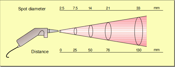

Simple infrared non-contact thermometers are generally total radiation pyrometers. The optical system of such infrared thermometer determines a circular measurement spot and the target must completely fill out this spot. Thus, the radius of the measured spot on the target has to scale with the distance. See, for example, Fig. 11 and 12 in [PDF]Principles of Non-Contact Temperature Measurement.

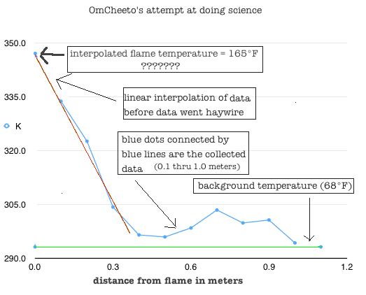

ps. This gives me a grand idea for a new experiment. I've had an infrared thermometer for several years, and it works great for measuring the temperature of big things, like my wood stove, the side of my house, etc. But it's pretty much useless for measuring small or odd shaped things, like candle flames or electric stove top heating elements. Although those two examples are thermally outside the range of my device, I'm wondering if I could use the 1/r2 law, and some maths, to semi-accurately measure their temperatures.

Let's assume you have an infinite plane with uniform temperature. The irradiance is constant with distance from this plane. However, when the device is closer it will get signal from a smaller spot, than when you move further away from the plane. Following this logic it should measure hotter and hotter temperature as you are going further away, since it would get signal from larger and larger spots. The measurement is however, distance independent.
I don't follow that logic.
misterwicked said:
If irradiance is constant with distance and the device measures incident radiation from a cone, then a signal coming from larger distance should be larger since the spot diameter is larger there. What am I missing?
The intensity (or irradiance) of infrared light radiating from every point source on the observed spot is inversely proportional to the square of the distance from the source. On the other hand, the area of the observed spot scales with the square of the distance.
Ok, so this is the key to understanding why measurement is distance independent. Irradiance falls by 1/r2 with distance and this is exactly compensated by larger spot sizes, which scale up by the same amount by which the irradiance decreases with distance. Thanks!
The test results do not look promising...
Charles Link said:
It is possible to calibrate a pyroelectric detector...
Just not by me. :confused:
Oh, my, god...
It's no wonder people* hate science. This is impossibly hard!
*young and impatient, and old and senile.
Oh, my, god...
It's not likely to work with a flame. In general, you just don't have the emissivity from the gaseous state (i.e. the emissivity will be much much less than 1.0), particularly when it is not a plasma. I think most of the light output from a candle flame is the result of atomic and molecular transitions. It does not behave like a blackbody, and there will be little correlation between what you measure (under the assumption that it is a blackbody) and the actual temperature. Any correlations that you would get between the radiated power and the actual temperature would be somewhat coincidental.
