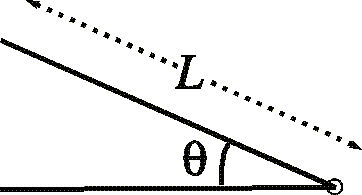

A uniform rod of length 1.25 m is attached to a frictionless pivot at one end. It is released from rest from an angle θ = 23.0° above the horizontal.
Find the magnitude of the initial acceleration of the rod's center of mass.
I keep getting the wrong answer. Please help with a push in the right direction.
You can use the fact that the center of mass lies at 1/2 * L and that gravity grips the rod here. You can then use a simple geometric rule to find the force perpendicular to the rod, hence its initial acceleration.
You can calculate the torque exerted by gravity, and hence the angular acceleration of the rod. This can be related to the linear acceleration (of for instance the CoM) by the formula
\alpha D = a
where D is the distance to the point of interest (CoM in this example)
