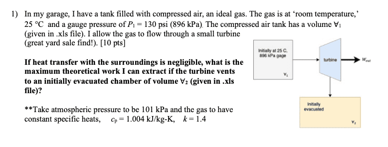

Given: V_1 = 10 L, V_2 = 22 L
Not sure what I need to do here. We are told to ignore heat transfer, and the problem suggests that this is not a steady-state problem. The gage pressure is given, so I think that means we need to calculate for the absolute pressure, which would be 997 kPa. Cp and k are given, which yields Cv = 0.717.
I was thinking to use the fact that we have two volumes and the absolute pressure, so use the definition of work and compute that integral. However, the problem isn't that simple. Maybe we need to take a control volume about the entire system? Not sure, please help.

Stephen Miller said:
Homework Statement: Initially evacuated chamber and maximum theoretical work
Homework Equations: Energy Balance Equation

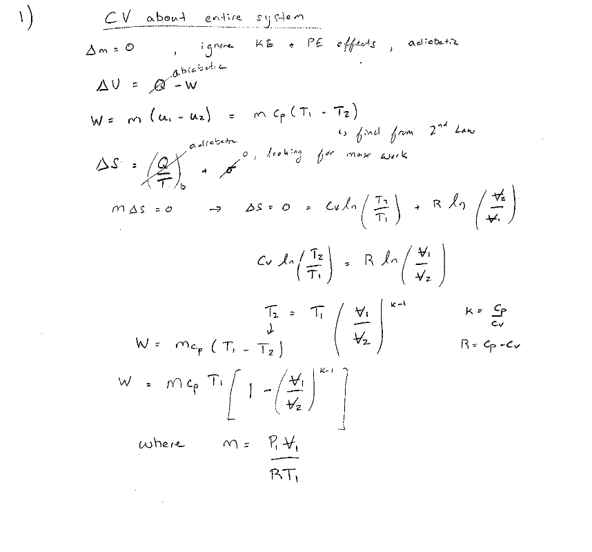

I don't know how to use LaTex, so here's an attached file instead :)
I hope that's right. I got a positive answer for W, which matches with W_out.

The final volume is not just the volume of tank-2, but rather the volume of tank-1 plus the volume of tank-2.
Is the volume of tank-2 12 liters or 22 liters? If it's 12 liters, then nevermind.
Also, in your final step you used the gauge pressure instead of absolute pressure for [itex]p_1[/itex].

I am not sure why one couldn't simply use the change in entropy formula considering the gas as the system undergoing a process from state 1 to 2 - with the turbine volume negligible. If so, then we have
##\Delta S = \int_{1}^{2} \frac{\delta Q}{T} + \sigma##
Since there is no heat transfer the integral is zero. If we are looking for the maximum theoretical work then the entropy generation term is also zero. So
##\Delta S = 0##
If this is correct, then we can use, for an ideal gas,
##\Delta S = 0 = c_v ln(\frac{T_2}{T_1}) -R Ln(\frac{V_1}{V_2}) ##
This means that we can use the relation
##\frac{T_2}{T_1} = (\frac{V_1}{V_2})^{(k-1)}##
So if we plug in numbers we find ##T_2 = 187.2K##. Then we can use the 1st Law for a system
##\Delta U = Q-W = 0 - W \rightarrow \Delta U= -W##
Now use the ideal gas relation for the change in internal energy,
##\Delta U = c_v \Delta T##
Finally, this results in
##c_v(T_2 - T_1) = -79.6 kJ = -W##
so the maximum theoretical work is ##W_{max} = 79.6 kJ##.

The entropy generation is zero only if the process is reversible. And the discharge and mixing of the expanded gas from the turbine with the gas already in tank 2 during the process is going to be irreversible.
Right. But if we are looking for the maximum theoretical work, we should consider all processes reversible. Of course this is never achievable, but this would establish an upper limit. So it seems to me.
The problem statement clearly says that the only equipment available are the 2 tanks and the turbine. We must come as close as possible to reversible within this constraint.
I assumed no other equipment than the tanks and turbine, so I am confused about why you would point this out. "As close as possible to reversible" is very near reversible. I assumed exactly reversible, which puts an upper limit on the "very near" part.
What am I missing?

$$n_2=n_{10}\frac{V_2}{(V_1+V_2)}$$
$$T_1=T_{10}\left(\frac{V_1}{V_1+V_2}\right)^{(\gamma-1)}$$
$$T_2=T_1=T_{10}\left(\frac{V_1}{V_1+V_2}\right)^{(\gamma-1)}$$
Now, for the parameters in this problem, $$n_{10}=\frac{(997000)(0.010)}{(8.314)(298)}=4.024\ moles$$
So, in the final state of the system, $$n_1=4.024(10/32)=1.258\ moles$$
$$n_2=4.024(22/32)=2.767\ moles$$
$$T_1=298\left(\frac{10}{32}\right)^{0.4}=187.1K$$
$$T_2=298\left(\frac{10}{32}\right)^{0.4}=187.1K$$
The change in internal energy for the system between the initial and final states is given by:
$$\Delta U=n_{10}C_v(T_1-T_{10})=(4.024)(20.79)(187.1-298)=-9278\ J$$
This is minus the maximum amount of work, so the maximum amount of work is +9278 J.
For the final pressure, I get 197 kPa
What am I missing?
I don't know. Have you looked over my analysis? Does anything look incorrect about that?
No, for your analysis is very detailed! One thing I notice is that the pressures aren't equal at the end, unless I have misapplied your results? (Perhaps this is round-off error.)
##P_1=P_{10}\left(\frac{n_1}{n_{10}}\right)^{\gamma}=997 \left(\frac{1.258 }{4.024 }\right)^{1.4}=195.7kPa##
##P_2=P_{10}\left(\frac{n_2V_1}{n_{10}V_2}\right)^\gamma = 997\left(\frac{2.676 *10}{4.024 *22}\right)^{1.4}=186.8kPa##
Also, the ideal gas law is not satisfied in tank 2, if the pressure above is correct (but it is satisfied in tank 1 given the above pressure).
For tank 1:
##P_1 = n_1*R*T_1/V_1 =1.258*8.314*187.1/.01 = 195.7kPa##
This is as above.
But for tank 2:
##P_2 = n_2*R*T_2/V_2 = 2.676*8.314*256.5/0.022 = 259.4kPa##
This differs significantly from above.
