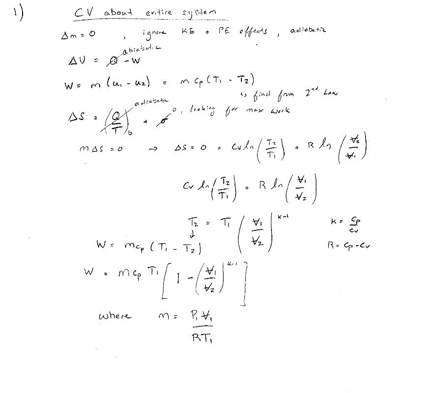

Thank you all for the help. The correct answer is in the attached file. That's the teacher's solution, so just plug and chug from there. My answer came out to be ##9.4367 𝑘𝐽##
  • Handwritten derivation titled CV about entire system: Δm = 0, ignoring KE and PE effects, adiabatic; ΔU = Q − W; W = m(u1 − u2) = m cp(T1 − T2); ΔS = 0 from the second law; then T2 = T1(V1/V2)^(k−1), with k = cp/cv and R = cp − cv, giving W = m cp T1[1 − (V1/V2)^(k−1)] where m = P1V1/(RT1).
With all due respect to your teacher, I stand by the solution I obtained in post #28: 9.278 kJ.
Yes, it seems the teacher made an error in writing:
##\Delta U = m c_p (T_2 - T_1)##
This should be written (for an ideal gas) as:
##\Delta U = m c_v (T_2 - T_1)##
Thus the work should be written, in terms only of the given parameters, as:##W = \frac{P_1 V_1 c_p}{R_{air} k} \left(1-\left(\frac{V_1}{V_1 + V_2}\right) ^{k-1}\right)##
