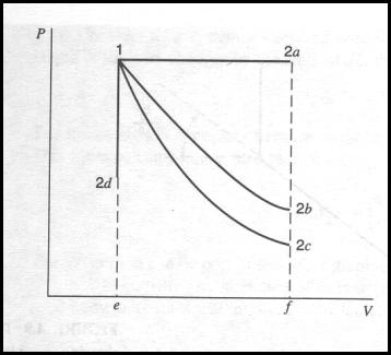

a) [/B]There is a piston-cylinder arrangement; initial pressure is 200 kPa, initial volume is 0.04m^3. Volume of the gas increases to 0.1 m3 while the pressure remains constant, ie a constant pressure process. Calculate the work.
b)
There is a piston-cylinder arrangement; initial pressure is 200 kPa, initial volume is 0.04m^3. Volume increases to 0.1 m3 while its temperature is constant, ie a constant temperature process.
c) There is a piston-cylinder arrangement; initial pressure is 200 kPa, initial volume is 0.04m^3. Final volume is 0.1 m3 but this time PV^1.3=constant during the process ie a polytropic process with n=1.3.
My question is: 1) Does constant pressure process always give the biggest work?
2) What polytropic exponent gives the biggest work?
3) What would be the case for a isentropic process with the same final volume?
4) How can we understand if the energy of the system increases or decreases, taking the
gas as a system?
1) dw=Pdv; P1V1^n=P2V2^n[/B]
1) [/B]
P-V diagram with pressure on the vertical axis and volume on the horizontal axis. Point 1 at top left; a horizontal line 1 to 2a (constant pressure), a vertical dashed line 1 to 2d at constant volume e, and two curves 1 to 2b and 1 to 2c ending at the dashed line f.
1) as you can see from the picture that constant pressure gives the biggest work, but I cannot be sure if it is always so?
2) if 1 is correct analyse then the answer to 2 should be polytropic exponent is 0.
3) I do not know this now but let me wait for it. I can answer it later.
4) I am not sure if this can be determined because we do not know what energy is given to the system so that we could use the equation Q-W=ΔE

Your answers look right. With regard to 4, neglecting non-ideal gas effects, the internal energy is a monotonic increasing function only of temperature.
But I cannot be sure if constant pressure process can be named as polytropic with exponent 0.
For 4, in the process a, b, c, constant pressure expansion, constant temperature expansion, expansion with polytropic exponent 1.3 respectively, only temperature is contant clearly for b by definition, but how can I determine the behavior of temperature for a and c. From what equation?

In c, we know that the temperature decreases for adiabatic reversible expansion. For b, the temperature is constant, but the pressure still decreases. How do you think the b process would have to be changed in order for the pressure not to decrease, as in a?

Oops. I got it in my head that, even though it said polytropic, I was thinking adiabatic. Actually, n=1.3 is pretty close to being adiabatic. For a monoatomic molecule, if the expansion is adiabatic, n = 1.67; if the molecule is diatomic, n = 1.4. Both these will involve temperature decrease. And, n = 1.0 means isothremal. So, 1.3 will also involve temperature decrease. An n = 0 will have to involve temperature increasing.

OK. Let's start out with the polytropic eqatuion. If we use the ideal gas law to substitute for the pressure in this equation, we get:
$$\frac{mRT}{V}V^n=C$$
From this, it follows that $$TV^{n-1}=C'$$where C' is a different constant. From this equation, what can you tell me about whether T increases or decreases with increasing V if n = 1.3, n = 1.0, and n = 0?

Yes, a) when n=0, equation becomes T/V=C so it is clear that when volume increases temperature is also increases but the curve is not linear.
b) when n=1, equation becomes T=C', I cannot understand this equation because I cannot relate it to volume.
c) when n=1.3 equation becomes TV^0.3=C', because exponent is bigger than 0, then when volume increases then T decreases.

This is the case where the pressure is constant.
As the volume increases, the temperature remains constant. This is the isothermal case. The pressure decreases as the volume increases, such that PV=constant.
