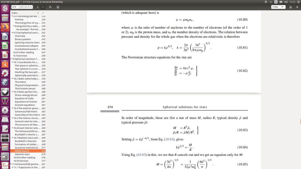

I have another question regarding his textbook in its second edition:
on page 274 it's written down equation (10.85) as: ##M= (3k^3/(4\pi))^{1/2}##, but I get only that ##M=k^{3/2}## without the numerical constant the includes ##\pi##.
Here are my calculations:
$$M^{1/3} = R\bar{\rho}^{1/3}$$
thus, ##R= M^{1/3}/(\rho^{1/3})##, plug the last equation to (10.84) to get:
##M/(M^{1/3}/(\bar{\rho}^{1/3}))=k\bar{\rho}^{1/3}##
i.e ##M^{2/3}=k##.
How did they get the numerical factor ##(3/(4\pi))^{1/2}##?

I can upload screenshots of the book, but it won't be from my hardcover copy...
I am attaching a pic of the two pages where my second conundrum appears for those who don't have the book.
