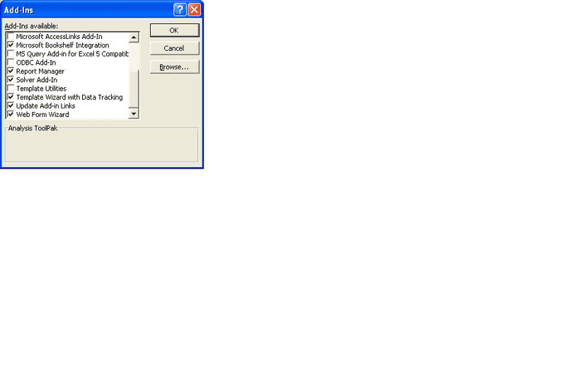

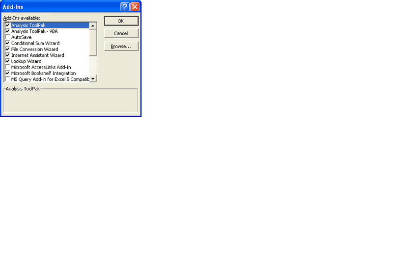

  • #48
jedishrfu said:
Another one to consider is freemat which uses Matlab like programming language and has charting capability. It’s simple to use too.
I was really expecting a Julia endorsement from you at some point here
Buzz Bloom said:
Hi Stone:
When I downloaded poptools325_setup.exe and executed it, the file "POPTOOLS Readme.xls" was displayed in Excel. Here is some of its content.
If you have Excel 97 you should install Microsoft Office Service Release 2b. Last time I looked (Oct 2003), it was available at:
http://office.microsoft.com/assistance/9798/sr2fact.aspx
If you can't find it there, try
http://office.microsoft.com/assistance/​
There is also a button, "Setup", on the "start" line on the bottom of the desktop. When I click on it, or right-click on it, nothing happens.
I sort of remember that I had installed Microsoft Office Service Release 2b a long time ago, but I can't figure out how to confirm this. Neither of the links in the Readme file quote above work.
