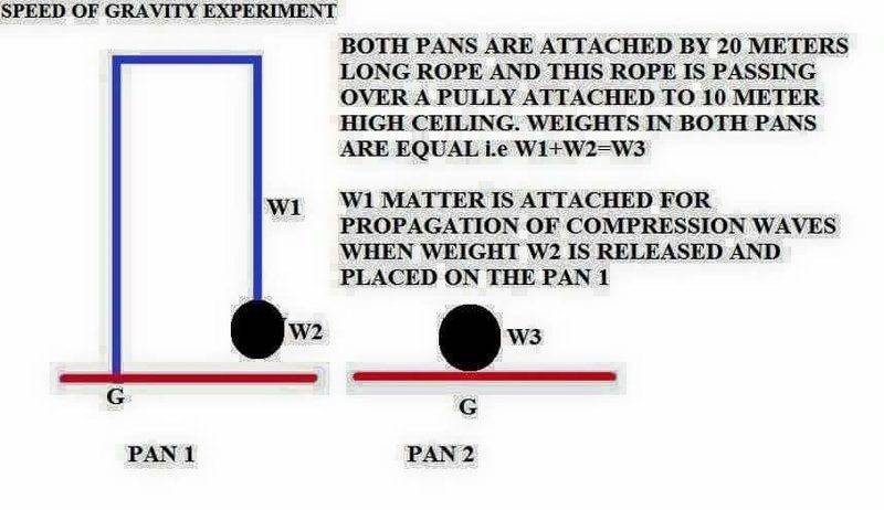

Diagram of a two-pan balance: pan 1 has a blue rope over a pulley from a 10 m ceiling, weight W1 on the rope, weight W2 resting on pan 1, labelled 20 m rope; pan 2 holds weight W3 on a red platform.
n ordinary weighing scale, in left pan, there is spiral shaped coil (like that mosquito coil) or any long shaped rod. Middle point of this coil is touching the left pan. Let mass of this coil be W1. Second body of mass W2 is attached to other end of this coil. So the left pan is experiencing total weight W1+W2. In right pan, there is mass M3 which mass is equal to W1+W2. So both pans are at same level from ground.
Now we remove weight W2 attached to coil. Info regarding removal of weight W2 travels to pan through spiral coil W1 in time t. During this delay t, left pan still experiences total weight W1+W2. If we put weight W2 - which is in our hand - on the left pan during this delay t, then pan will experience total weight W1+W2+W2 which is greater than W3 in right pan.
So obviously left pan will come down and right pan will go up during this propagation delay t.
That means we have created excess energy and law of conservation of energy is broken. Am I right?

Actually, you never mention a speed of gravity in your post, so it isn't clear how you could conclude anything about it from what you described.
But in either case, you are stating that there are two possible conclusions, and there aren't: there are three:
1. Finite SOG=excess or missing energy.
2. Infinite SOG=no excess or missing energy.
3. There is energy somewhere else that isn't accounted for in #1.
And #3 is the answer, and the experiment doesn't tell us anything about the speed of gravity. Why? because you are transmitting the force via mechanical interaction in the rope, not via gravity.

There is some amount of potential energy stored in the spring because it is under tension from supporting W2. When you remove W2 the spring relaxes, releasing that potential energy to push the left-hand pan down and raise the right-hand pan.
And I have devised this experiment to show that speed of gravity is instantaneous. If it is not instantaneous, then its finite speed can be used to create excess energy. It doesn't mean that I am discussing "free energy". I am discussing instantaneous speed of gravity.
No excess energy has been created; you've just used the potential energy in the spring to displace the pans.
Nor is this a measure of the speed of gravity, as gravity is acting on all parts of the system at all times. It's just that during the very short period of time after you've removed W2 from the spring, there is a force other than gravity, namely the force from the relaxing spring, that is also acting on the left-hand pan.

The system is not big to raise "somewhere" doubt. Let us make this system more simple. Our weighing scale consists of simple horizontal rod supported in the middle by vertical pointed rod. Let us remove pans also and place spiral coil (W1+W2) on left side of this horizontal rod and W3 on right side of this rod. Let length of this horizontal rod be less than length of spiral coil (W1). Now where exactly your missing energy is stored in this small system?
Any real world rod is not perfectly rigid, so it can store elastic energy when deformed.

Exactly the same place as where it was before: in "spring energy" (elastic energy).
The problem with your experiments is that you are making your devices interact mechanically and then claiming it says something about gravity. If you want to say something about gravity, you have to test gravitational interactions!
Try this instead:
Two pendulums, suspended from the ceiling, some distance apart. Gravitational interaction pulls them together by some amount. Now grab one and yank it away. Does the other one move away instantly or not? If not, what does this say about conservation of energy/speed of gravity?

The left hand pan has no information (as per current theory) during propagation delay t. That means no matter what you do at W2 point, the left pan will not feel anything. That means it will not push down anything. And I am taking advantage of this propagation delay. I removed W2. Left pan has no information about event happened at other end of spiral coil during propagation delay t. I removed W2 and put down it on left pan during t. (Note that you can shift position of W2 from coil to left pan just by sliding it)

If you have a certain amount of energy in a system now, and then later on the amount is less than it was before, the difference is the "missing energy".
Example: A system has 13 J of energy now, then later it has 11 J, the missing energy is 2 J.
You have an object and you apply a force to deform it. When you stop applying the force the object returns to its original shape. The work done by that force is equal to the "spring energy".
Example: A rope has a length of 20.00 meters. A force is applied, stretching the rope to a length of 20.01 meters and doing 3 J of work. The "spring energy" stored in the stretched rope is 3 J.

You seem to understand it pretty well, but maybe just aren't aware of the result that stretching or contracting springs stores energy:
https://en.wikipedia.org/wiki/Elastic_energy
This is the energy that is being released to move the balance pan when the weight is removed. Not gravitational force/energy.
And you should be able to figure this out logically, since your experimental setup doesn't actually require gravity at all. You used gravity as a roundabout way to apply a force to the balance pans, but you didn't need to, because gravity itself does not act on the pans. The pans are being physically pushed by the weights. So if you replace the weights with literally anything that can apply a force (more springs, cables, pistons, your finger), you eliminate gravity from the experiment and it produces the exact same result.
