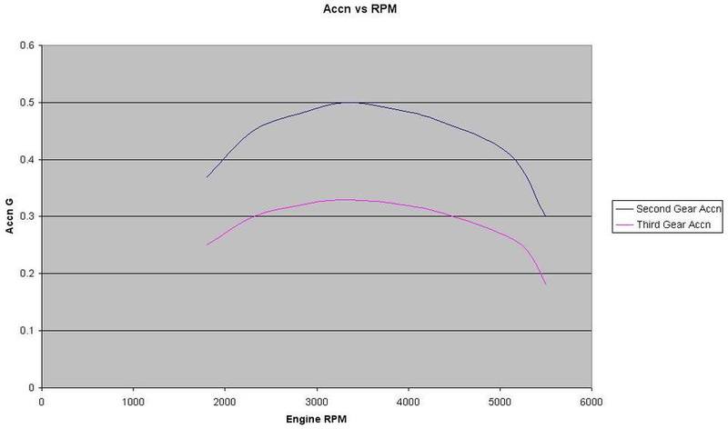

I did this quite a while ago so I've got got all the data anymore unfortuately, but here is accelorometer data for MK4 golf Gti 20vT. The car was a little sick at the time and not putting out the torque it should have been so the G figures are a bit low. It was putting out about 140BHP@5500 RPM at the time and should have been putting out closer to 180BHP. (turbo remaps are win!)
I can't find the dyno plot from around that time either so I can't show that acceleration almost directly follows the torque output line. It was only a cheap crappy acceleromoter to the accuracy isn't fantastic, but was good enough to show the trend the accn directly followed torque.
Like I said it's not 100% relevant as I didn't record the acceleration on rundown or with the clutch in as it wasn't relevant to why I collected the data. But I can assure you that when the clutch was in there was no acceleration on flat ground.
