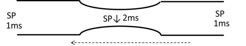

Diagram of a pipe with a constriction; upper line labelled SP 1ms on the left and SP 1ms on the right, with the narrowed section labelled SP down arrow 2ms; a dashed arrow below points left.
This leads me to conclude this must happen instantaneously.
It also lead me to conclude that the pressure difference in this situation is in some ways a result not the cause (as I have seen often stated) of the increase in speed. At best it is concurrent and independent.

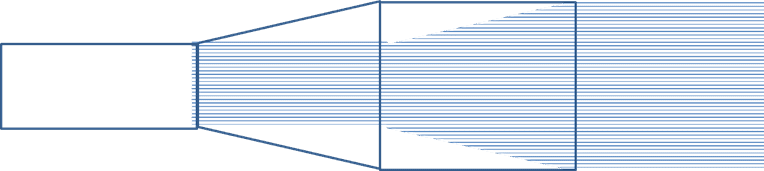

It involves the inertial flow creating some acceleration in the stream entering and the inertial flow behind creating a suction force that allows static pressure to be converted to flow/dynamic pressure

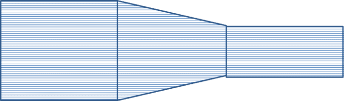

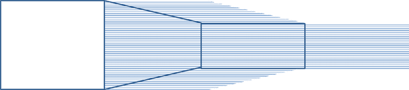

1 ) Inertial Entry acceleration
As the volume per second at the entrance must continue there is a larger volume/mass entering than inside the construction
at T0
Diagram of a pipe with a wide section on the left, a tapered converging section in the middle, and a narrower section on the right, with horizontal flow lines drawn throughout.
at T1 under inertia
Diagram of a pipe with a wide section on the left, a narrow section in the middle, and a wide section on the right, with horizontal flow lines drawn through it.
Now this can’t happen but the larger entry mass/KE acts on the smaller and smaller mass contained causes work on the smaller volume/ mass in front thus accelerates it
This would cease when the throat speed (exit) is accelerated to 2v- the exit speed that fully dispenses the entry volume 2A at 1v.
The problem is that as this is action is purely inertial.
The Total KE is the same (just shared with a smaller and smaller mass in the constriction) So we haven't accounted for all of the KE increase to increase throat speed to the required velocity 2V to deal for the whole volume- We also require a conversion of static pressure to dynamic to balance the energy equation.
This is provided by

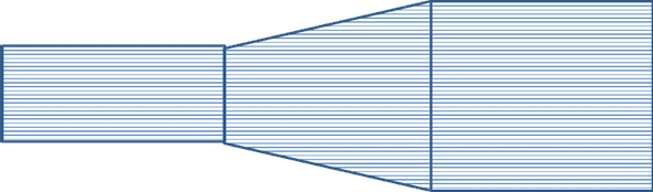

Inertial Exit Suction
Equally the volume just behind the exit will continue to flow (by inertia) away and must be replaced by the volume in the expansion - while this is traveling at the same speed there is a volume deficit to fill the ‘cavity’
This volume deficit creates an area of suction in the construction which allows a low pressure zone in the expansion for the construction static pressure to flow streamwise into and thus is converted to Dynamic Pressure
T0
Diagram of a pipe with a narrow section on the left, widening through a tapered section to a wider section on the right, drawn with horizontal flow lines.
at T1 under inertia
Diagram of a pipe with a wide section on the left narrowing through a converging cone to a narrow section, then widening through a diverging cone to a wide section, with many horizontal streamlines drawn through it.
This suction will cease to occur when the inflection point is accelerated to 1.5V and fully providing with the required volume at the exit
Throat speed 2v, inflection point 1.5v, Exit 1V
allowing the normal slowing of the flow back to 1v and normal static pressure at the exit

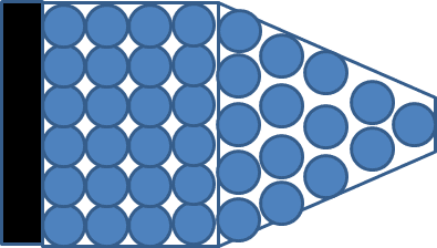

Diagram of a horizontal pipe of uniform width filled with blue liquid, with a black piston block at the left end, that narrows to a constriction and then widens again at the right end.
A pipe fully filled withinitially static incompressible inviscid liquid with a piston on one end. The pipe has a constriction in it then an expansion
Diagram of a horizontal pipe filled with blue liquid, with an arrow labelled Force pushing from the left end; the pipe narrows into a constriction and then widens at the right.
The piston is then subject to force (pressure difference) will have a front which initially propagates down the liquid at the speed of sound (~900ms) I I want to understand what happens when it initially encounters the constriction.Attempt at a solution
At the constriction the KE is shared with less and less mass in front - if we split into equal width sheets (fluid elements)
Diagram of a pipe section drawn as a trapezoid with vertical lines, narrowing from a tall left end to a shorter right end, showing a constriction in the flow channel.
Diagram of a pipe with a constriction: four vertical blue bands, each labelled KE, drawn as parallel sheets of fluid across a tapered channel that narrows then widens.
For equal KE the differences in mass will cause a differential acceleration F=m.a between each sheet /element - each will be accelerating at a faster rate than the one behind
Schematic of a pipe narrowing: five vertical parallel strips in a row, alternately outlined and shaded blue, shown in perspective with decreasing width from left to right.
This difference in "space" between elements in front (larger) than behind (smaller) allows an initially equal static pressure a greater mean free path/distance ahead than behind to flow into, by this mechanism is converted to dynamic pressure in the streamwise direction.
Bernoulli's variation is caused by the differences in mass causing increasing acceleration allowing a secondary directional conversion of static pressure to Dynamic
Thoughts ? Can someone poke a hole in this ?

how is that so? if we go down to the molecular level and we say that the piston depresses just 1 molecular depth
Diagram of a row of blue circles representing molecules in a pipe that narrows from left to right, with a black piston block on the left edge and the layers of circles compressed into fewer columns toward the constriction on the right.
Diagram of a pipe narrowing to the right, with a black box labelled D = v on the left, and blue circles representing fluid molecules arranged in six rows that compress into fewer rows at the constriction.
then once the first layer moves 1 layer to the right it is in its final position (with a velocity of zero) KE~of zero it has now passed its KE energy on to the next layer and so on .
This doesn't hold when mass changes ,Once it hits the constriction it has smaller mass for same force we must have differing acceleration
Looking at it from momentum. Momentum is conserved ? So for a smaller mass we must have a larger velocity. Acceleration is Vfinal -VInitial so acceleration is different
Assuming a frictionless environment of perfectly elastic collisions within a incompressible fluid.
