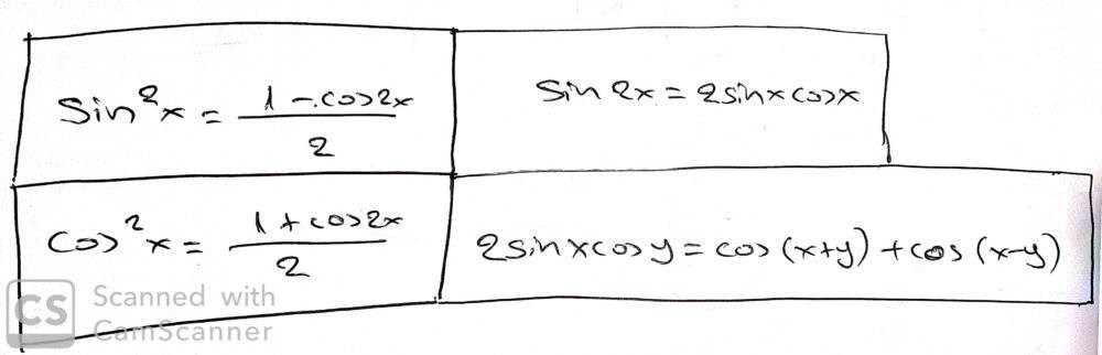

Thanks for your answers! I tried another way using the following trigonometric transformation formulas:

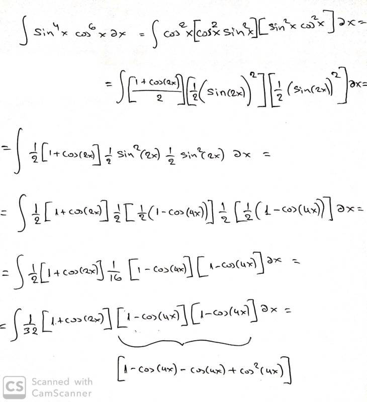

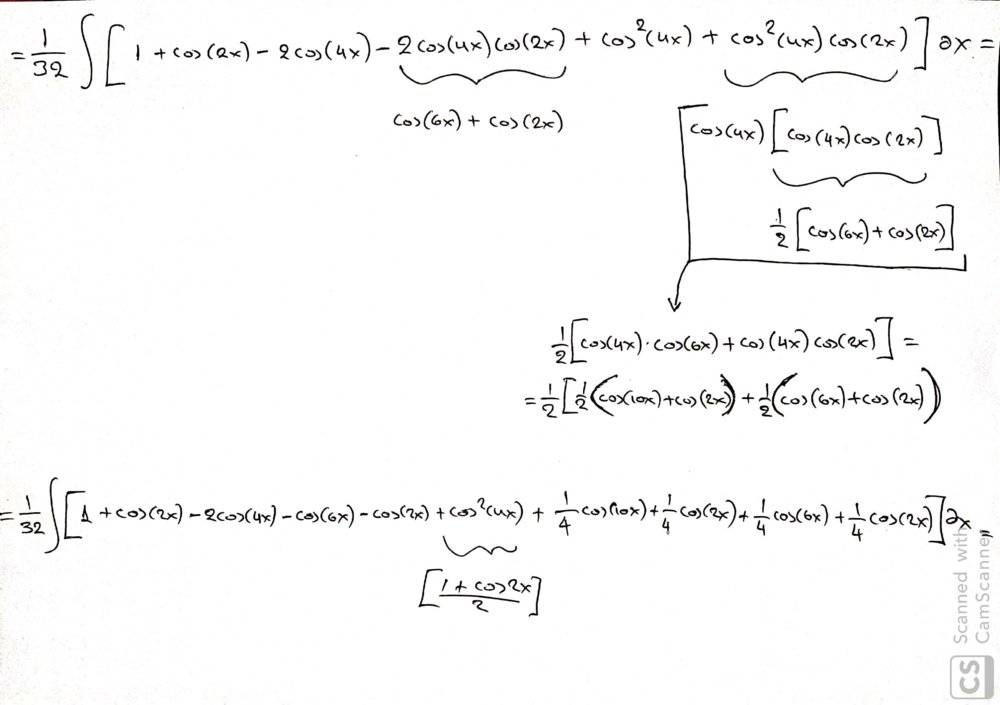

Now it's in simple format:
Do you know a better - faster way to solve it ?
Thanks.
