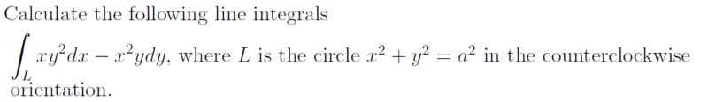

Typeset problem: Calculate the line integral of xy^2 dx minus x^2 y dy over L, where L is the circle x^2 + y^2 = a^2 in the counterclockwise orientation.
My attempt:
Let ##x=a \cos \theta## and ##y=a \sin \theta##
$$\int_{L} xy^2 dx-x^2ydy$$
$$=\int_{0}^{2\pi} \left( (a\cos \theta)(a\sin \theta)^2 (-a\sin \theta)-(a\cos \theta)^2 (a \sin \theta)(a\cos \theta)\right) d\theta$$
$$=-a^4 \int_{0}^{2\pi}\left( \sin^3 \theta \cos \theta+\cos^3 \theta \sin \theta \right) d\theta$$
I get zero as the result of the integration. Is it possible? Thanks
