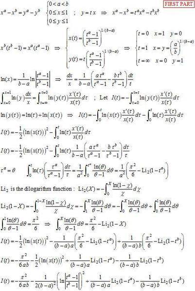

I'm a bit stumped with a problem I have recently seen. Here it is:
There is a continuous and decreasing function [tex]y(x):[0,1] \to [0,1],\mbox{ }0<a<b[/tex] and [tex]x^a-x^b=y^a-y^b[/tex]
Prove that [tex]\int_{0}^{1} \frac{\ln y}{x} dx=-\frac{\pi ^2}{3ab}[/tex]
The trivial solution of y=x causes the integral to diverge. Frankly, I'm at a loss on how to approach this problem. Clearly you cannot solve for y in general as a and b can also take on non-integer values.

That's how the problem was presented. Also, y is a function of x, not a constant. As such, it cannot be removed from the integral.
I have implicitly plotted [tex]x^a-x^b=y^a-y^b[/tex] for various values of a and b and I can see the two solutions for y. One is x, and the other fits the definition of y(x) given in my original post.
In fact, it almost looks like a circle. Putting in [tex]y=\sqrt{1-x^{2}}[/tex] into the integral produces [tex]\int_{0}^{1} \frac{\ln y}{x} dx=-\frac{\pi ^2}{24}[/tex]

Just to clarify the problem, I worked the trivial case of a=1, b=2. Then you get either y=x, for which the improper integral diverges, or y=(1-x) for which the improper integral is π^2/6, consistent with the stated general formula. I don't have any suggestion for where to go from there ... just that the problem as stated seems plausible.
It seems unlikely that there will be a closed form solution for y since a and b can take on non-integer values as well. However, there may be a series representation of the logarithm of y. That can be integrated.

Change of variable, x = eu+v, y = eu-v. Equation becomes
e(b-a)u = sinh(av)/sinh(bv)
Meanwhile, by symmetry about the u-axis, the integral becomes
I = ∫0(v-u).dv = ∫0((av - ln(sinh(av)) + bv - ln(sinh(bv)))/(b-a))dv
0(av - ln(sinh(av)))dv = ∫0(v - ln(sinh(v)))dv/a
I = ∫0(v - ln(sinh(v)))dv/ab
v - ln(sinh(v)) = -ln(1-e-2v) = Ʃe-2vn/n
I = Ʃ[-e-2vn/2n2]v=0/ab
= π2/12ab
Can anyone see where I lost the factor of 4?

I think there are several things wrong with this, as suggested by Mute. However, it looks promising. I suggest working it out with the trivial case I gave (a=1,b=2), to clarify the issues. If I apply my understanding of what you suggest above to this case, it leads to nonsense. Meanwhile, directly dealing with:
y=(1-x), you get polylog(2,x) for the antiderivative, and this is zero for zero and π^2/6 for 1, giving the right answer. Working out your suggestion for this simple case should track down issues you (I think) have with limits of integration, dropped terms, etc.

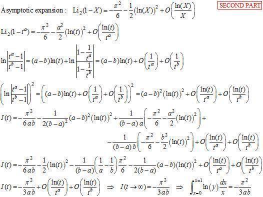

(In response to a request to rewrite in tex, correcting a few typos, and apparently finding my scaling error as a bonus:blushing:)
[itex]e^{(b-a)u} = sinh(av)/sinh(bv)[/itex]
[itex]I = \int^{0}_{-∞}(v-u).dv = (4/(b-a))\int^{0}_{-∞}(-av + ln(sinh(av)) + bv - ln(sinh(bv)))dv[/itex]
(The region being integrated in the uv plane lies between the lines u = v < 0, u = -v > 0, and the curve. This is symmetric about the u-axis, so is twice area bounded by that axis, u = -v > 0 and the curve. For a given v < 0, the range of u for the area lies between the curve and -v. Hence the value to be integrated is the difference of the two.
The halving of the range provides a factor 2 in the expression for I. The other factor of 2 is because the substitution introduces a scaling: dxdy = 2dudv... got that backwards originally)
[itex]\int^{0}_{-∞}(-av + ln(sinh(av)))dv = a^{-1}\int^{-∞}_{0}(v - ln(sinh(v)))dv[/itex]
Applying this to both the a and b terms, the factor b-a cancels:
[itex]I = 4(ab)^{-1}\int^{-∞}_{0}(v - ln(sinh(v)))dv[/itex]
[itex]v - ln(sinh(v)) = -ln(1-e^{-2v}) = \sum e^{-2vn}/n[/itex]
[itex]I = 4(ab)^{-1}\sum[-e^{-2vn}/2n^2]_{v=0}^∞[/itex]
= π2/3ab

The integral is one-dimensional. y is a function of x; similarly, either u must be a function of v or vice versa. I do not see how quoting a Jacobian result for [itex]dxdy \rightarrow |\mathcal J| duduv[/itex] (bolded in the quote) applies; furthermore, on the basis of your change of variables the Jacobian should be -2exp(2u), not just -2. If you did not mean a Jacobian by that expression, then you need to clarify what you did mean, because I am not following your argument.
It would be helpful if you drew the picture you have in mind when you make these symmetry arguments.
It would also be rather instructive if you could actually show mathematically, without using graphical arguments, that
[tex]\int_{-\infty}^\infty dv (v-u)\left[ \frac{du(v)}{dv}+1\right] =_? \int_{-\infty}^0 dv (v-u)[/tex]
(there may be a sign error there, and I haven't double-checked the limits PAllen gets for v).
At the moment, I still find your symmetry argument confusing, and it looks to me like you are mixing results, or at least notation, from one and two dimensional integrals.
Also,
[tex]v - \ln(\sinh(v)) = -\ln(1-e^{-2x}) + \ln 2,[/tex]
but in your derivation you leave out the ln2, which is integrated over and would give a divergent result. The integral of v - ln(sinh(v)) does not actually converge. On [itex](-\infty,0][/itex], the area is simply unbounded, as can be seen by plotting. These are the original limits you wrote down which you then switch to [itex][0,\infty)[/itex], so perhaps you still have a typo, but even on this interval, the function levels off to ln2, so the area still diverges unless that ln2 is subtracted off, but that doesn't occur in the derivation offered.
