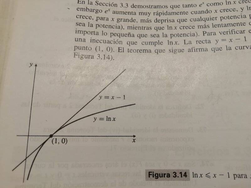

Hi, PF, there goes the theorem, questions, and attempt
THEOREM 4 If ##x>0##, then ##\ln x\leq{x-1}##
PROOF Let ##g(x)=\ln x-(x-1)## for ##x>0##. Then ##g(1)=0## and
##g'(x)=\displaystyle\frac{1}{x}-1\quad\begin{cases}>0&\mbox{if}\,0<x<1\\
<0&\mbox{if}\,x>1\end{cases}## (...). Thus, ##g(x)\leq{g(1)=0}##, ## \forall {x>0}## and ##\ln x\leq{x-1}## for all such ##x##
Question: The proof, why implies the quick growth of ##e^x## and the steady growing of ##\ln x##?
Attempt: ##g## grows in ##x\in{(0,1)}## and decreases in ##x\in{(1,\infty)}## (##g'(x)>0\,\forall{(0<x<1)}## and ##g'(x)<0\,\forall{(1<x<\infty)}##
Greetings!
Let us take the latter question first: "How does the proof imply the steady growth of ##\ln x##?
What do you even mean by the "steady growth" of ##\ln x##?
Certainly the proof examines the difference between the first derivative of ##\ln x## and the first derivative of ##x-1##. It concludes that the "growth rate" (first derivative) of ##\ln x## is less than the growth rate of ##x-1##.
By itself, this does not assure us that ##\ln x## even has a growth rate. But we can easily see that indeed, ##\ln x## is strictly monotone increasing.
I suppose that "strictly monotone increasing" with a growth rate that is always less than 1 might count as "steady growth" to you.
Personally, I'd use the adjective "steady growth" for something with a growth rate that converged on a positive constant. ##\ln x## does not qualify.We are in a position now to attack the other question: "How does the proof imply the quick growth of ##\ln x##?
That answer is shorter. It does not.
Roughly speaking, the proof of the first part puts a bound on the graph of ##\ln x##. It bounds it below a 45 degree line, the graph of ##f(x) = x-1##. The graph of ##e^x## will be the mirror image, obtained by swapping the x and y axes. The proof puts a lower bound on ##e^x## at the mirror image 45 degree line, the graph of ##f(x) = x + 1##.
There are plenty of "steadily growing" functions with such a lower bound.

This is, for all ##x## and ##y## such that ##x\leq y\rightarrow{f(x)\leq{f(y)}}##. One question: how could I get some info on growth rate?
Now, the question I do not solve is that ##e^x## increases more slowly than any positive power of ##x## (no matter how large the power), while ##\ln x## increases more slowly than any positive power of ##x## (no matter how small the power). The fact that ##g(x)\leq{g(1)=0}## for all ##x>0## and ##\ln\leq{x-1}## for all such ##x## is bounds, but not a proof of the singular growing properties of ##\ln x## and ##e^x##.
Now I think that it is all about introducing exponential growth and decay models, a few paragraphs forward.
Greetings!
The terminology I learned (in the 70's) for that attribute is "monotone increasing".
If one strengthens the inequality to ##x \lt y \rightarrow f(x) \lt f(y)## then the term is "strictly monotone increasing".
So a constant function such as ##f(x) = 1## would be "monotone increasing" but not "strictly monotone increasing". A function such as ##f(x) = x^3## would be both monotone increasing and strictly monotone increasing despite the inflection at ##x=0##.
Here, you appear not to be worried about any constant multiplier or fixed offset. So, for instance, you would say that ##x^2## increases more rapidly than ##10x + 15##.
That sounds like an application for "big O notation".
