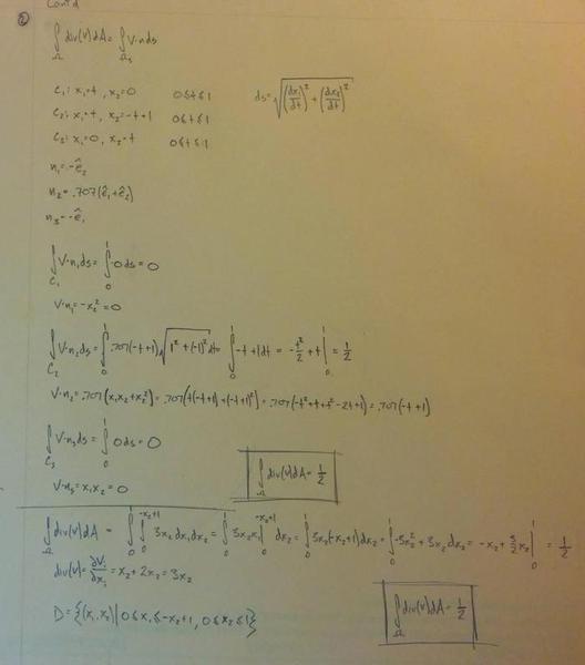

Hello, I'm hoping somebody can give me some insight on how to solve this problem. This was a solid mechanics exam question and I wasn't able to finish it because I'm rather weak in math.

I can apply divergence theorem no problem.
For the n vector field I get:
n1 = -e2
n3 = -e1
n2 = .707(e1 + e2)
The problem is that I've been out of school for quite a while, and I can't remember how to successfully integrate over the surface (perimeter) now. I realize I need to break it up into parts for each line of the surface, but it's been years since I've taken calculus.
For c1, you will have ##\int_0^1 V\cdot n_1 \, dx_1##.
For c3, you will have ##\int_0^1 V\cdot n_2 \, dx_2 ##.
For c2, it gets a little tougher.
##\int_{c2} V\cdot n_2 dc2##
For c2, should I do a double integral (x1 and x2, both from 0 to 1) of V⋅n2?
It might be easier to directly compute the Area integral
##\int_0^1 \int_0^{1-x_1} div(V) dx_2dx_1 ##
I don't think that is right, you would be taking the integral over an area. you want the integral over the line.
Thanks RUber, I think you've provided the help I needed to finish it. It was required to perform divergence theorem for the exam though, I'll give it a shot with both methods and see how the solutions compare.

Try integrating over x1, and define x2 in terms of x1 along the line. That should do the trick.
I solved it, I get 1/2 using both methods. Thanks again for the help RUber, it helped set me on the write path.
When I worked it out, I still had the ##\frac 1 {\sqrt{2}}## in the answer.
I'm not sure where the square root comes from, but I believe the accepted solution was 1/2 when we went over the exam (he just didn't take the time to go over something trivial like integration since most of my peers are coming straight out of undergrad >.<). I calculated it both by using divergence theorem to integrate over the line (more complicated) and by integrating the divergence over the area directly.
Aha, I forgot to multiply by the ##\sqrt{2}## in the dS term.
Good work.
Why (in post #7) "Nevermind this...that doesn't make any sense." ?
I thought I had div V = 3x2 and that would be a simple integral, so I'm grossly overlooking sonething ?
Thanks BvU, I was clearly overthinking things and convinced myself I was wrong.
