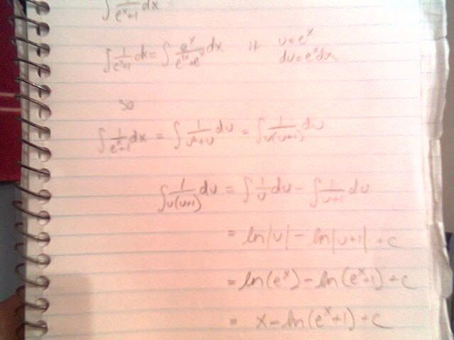

I need to find the integral of (1/(1+e^x)) dx.
...I don't think I can use u substitution, but well, I'm basically open to suggestions.
It should be solvable with substitution. Hint: u = 1+e^x
but, then wouldn't du = e^x dx? That would require a (1/e^x) outside the integral to balance it out, but my Cal I teacher (I'm now in Cal II with a different teacher) told me that I couldn't do this.
Write x in terms of u, and then take the differential.
let u = 1 + e^x
then we know du = (e^x)dx
and e^x = u -1
is there something we can multiply both the numerator and the denominator by to make this substitution work? Hint: this will turn it into a partial fraction decomposition problem.
Multiply by 1. (1=e-x/e-x)
That multiplication isn't really necessary. JonF's first point was sufficient: if u= 1+ ex, then ex= u- 1. du= exdx= (u-1)dx so dx= du/(u-1).
[tex]\int\frac{dx}{1+e^x}= \int\frac{du}{(u-1)(u)}[/tex]
which can be done by partial fractions.

I don't even think partial fractions are necessary. u(u-1)=u^2-u
so
[tex]\int\frac{dx}{1+e^x}= \int\frac{du}{(u-1)(u)} = \int{1 \over u^2-u}du = ln(u^2-u) + C = ln(e^{2x} + e^x) + C[/tex]

How on Earth do you do partial fractions on exponential functions?
you don't do it directly you substitute to get some polynomials.
@ camilus: that integration is wrong you don't have the derivative of (u^2-u) on the top which is needed in order to get ln(u^2-1) + C as the answer so you would have to do partial fractions.
so
Nope, doesn't work out...
The logorithmic integration rules do not work that way. The integral of "1/(x+x^2)" =/= ln(x+x^2)
You'd have to start doing trigonometric sub/partial fractions after this point.

[tex]\int \limits_0^1 \frac{dx}{1+e^x} \approx 0.379885493[/tex]
[tex]\int \limits_2^{e+1} {1 \over u^2-u}du \approx 0.379885493[/tex]
most of yall need to retake calc 1, apparently everyone disagrees with the correct answer...
you're missing some calculus there, the derivative of ln(u^2-u) is not your integral.
not ln(u^2+u), ln(u^2-u)...
yea I meant that >_> sorry
And it's still not true. [itex]\frac{d}{du}\ln\left(u^{2}-u\right) \neq \frac{1}{u^{2}-u}[/itex].
Hmm d/dxln(u^2-u) is (1/u^2 - u) * 2u
I'm pretty sure I did the derivative right, so camulis where did I error?
