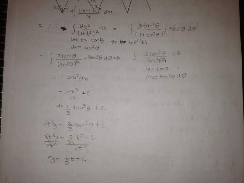

Litcyb Messages 34 Reaction score 0 Thread starter Jun 7, 2013 #1 Homework Statement integrate 2t^(2)/(1+t^2)^(2) Homework Equations trig sub 1+tan^2(x)= sec^2(x) The Attempt at a Solution the attempted solution is attached. Attachments photo (2).jpg 22.3 KB · Views: 471
ehild Science Advisor Homework Helper Messages 15,536 Reaction score 1,917 Jun 7, 2013 #2 Your derivation is not correct and the method you follow is a bit complicated. Try integration by parts, ∫u'vdt=uv-∫uv'dt, with u'=2t/(1+t^2)^2 and v=t. ehild Last edited: Jun 8, 2013
SteamKing Staff Emeritus Science Advisor Homework Helper Messages 12,828 Reaction score 1,673 Jun 7, 2013 #3 If y = (1/3)t + C, then dy/dt = 1/3, which is clearly not even remotely close to the original integrand.
