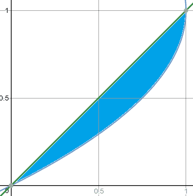

The first thing I would do is sketch the region to be revolved:
Now, what is the axis of rotation?
