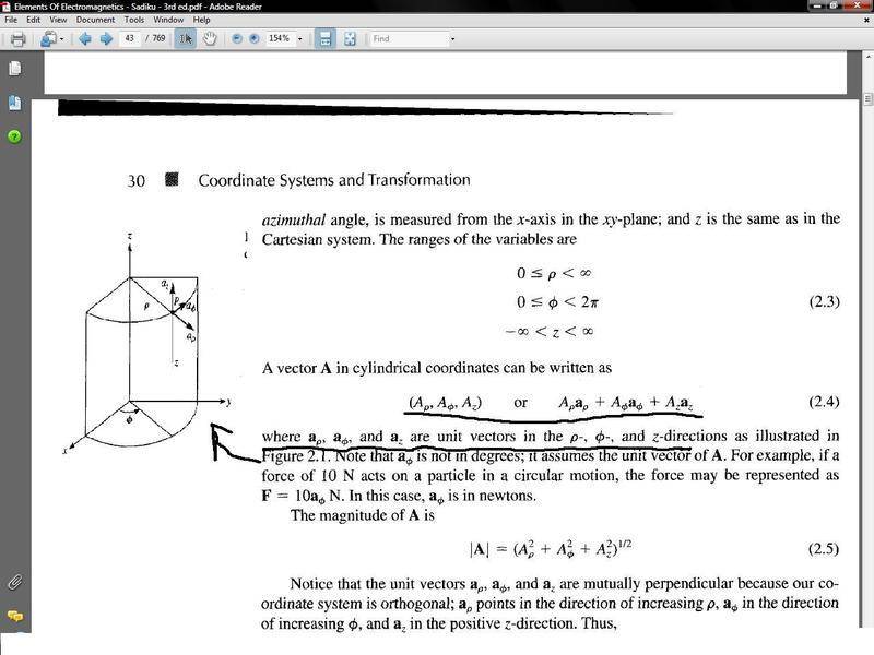

In cyclindrical coordinates we can represent points as ([tex]\rho[/tex],[tex]\phi[/tex],z)
We define a vector in cyclindrical coordinates as follows
A = A[tex]\rho[/tex]a[tex]\rho[/tex] + A[tex]\phi[/tex]a[tex]\phi[/tex] + Azaz
I'm having some problem with subscripts.
Anyway I don't understand this.
If I am given a point say ( 5, 20 deg, 4)

How can I determine A[tex]\rho[/tex], A[tex]\phi[/tex]

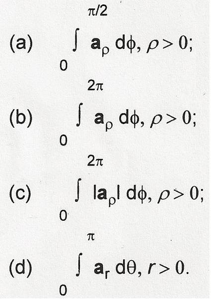

And my prof gave us a review question for vector calculus but I don't seem to understand the question geometrically.
It says [tex]\int[/tex]a[tex]\rho[/tex]d[tex]\phi[/tex] from 0 to pi/2
having a bit of trouble with the latex.
Anyway the function in the integral is the unit vector a[tex]\rho[/tex]
I just need to understand what the integral is asking for in other to attempt it. I'm having some trouble working with cylindrical coordinates in the way it's defined in my field theory book.

Well this is the integral we were given to evaluate. I am also hopelessly confused which is why I'm asking the question.
I provided images if they help . Can you just point me in the right direction if you can!Or can you direct me to a book with gives a through consideration of cylindrical Coordinates my book is a piece of crap and my multivarible cal book did not cover cylindrical in this manner it was more straight forward in it's approach.

Ok. Maybe they mean you convert the vector to Cartesian coordinates and then just integrate? a_rho=(cos(phi),sin(phi),0). Just integrate component by component. The result will an Cartesian vector if the integrand is a vector - a scalar if it's not.
You need two points for a vector.
The vectors in your questions do not start from the origin, they start from eg (5, 20º, 4).
aφ etc are different unit vectors at each point.
To evaluate eg ∫0π/2 aρ dφ,
you go round the curve (you haven't said what it is … is it a circle of radius ρ? :confused:), integrating the different "radial" unit vector aρ for each point on the curve. :smile:

Okay thanks. I don't know why the prof defined the integral is such a way. My next question is what is the interpretation of this integral ? The area under what ?
dφ and aρ are orthogonal to each other because dφ is in the same direction as aφ

okay I understand what you mean. What about if I have two points say (5,45º,2) and (4,25º, 1) without using the equations:
x= pcosφ
y = psinφ
To find the cartisian equivalent how can I determine
[tex]A\upshape\rho[/tex] and [tex]A\upshape\phi[/tex] to present the vector from (4,25º, 1) to (5,45º,2) in the form
Aρaρ+ Aφaφ + Azaz.
I am aware that to represent a position vector only two unit vectors are needed namely,aρand az because the unit vector aρ depends on the position of the unit vector aφ
As for the integration my real question is what exactly does this integrand mean... I mean we intepret an integral as the area under a curve but how can I interpret this ?

… what is the interpretation of this integral ? The area under what ?
An integral only works as an area if all the vectors are in the same direction.
aρ, for example, keeps changing direction.
There isn't really a geometrical way of understanding a vector integral along a curve (though I suppose you could imagine all the aρs being moved to the same point, and then added together vectorially).

You have to choose where the vector is "anchored" … if it's anchored at the first point, you use the unit vectors of that first point, and express the vector in components of those unit vectors.
Can you perhaps elaborate a bit more ? Perhaps an example ?
I'm not sure what you mean by "use the unit vectors of that first point, and express the vector in components of those unit vectors".
An quick example would be highly appreciated because I always convert back to cartesian find the position vector and then back to cylindrical coordinates which is a daunting and involving task .
The three unit vectors at one point form an i j k frame.
You have to write the vector as ai + bj + ck.
(You do not "convert back" to cylindrical coordinates, you leave it like that.)

Perhaps a simpler example would help. Suppose you have the vector [tex]\vec{v}=(v_x,v_y,v_z)=(1,2,3)[/tex] located at the point [tex]\vec{x}=(x,y,z)=(0,4,0)[/tex]. The point [tex]\vec{x}[/tex] is represented in cylindrical coordinates as [tex](r,\phi,z)=(4, \pi/2, 0)[/tex], and the three cylindrical unit vectors for that point, represented in Cartesian coordinates, would be
[tex]\hat{a}_\rho = (0,1,0)[/tex]
[tex]\hat{a}_\phi = (-1,0,0)[/tex]
[tex]\hat{a}_z = (0,0,1)[/tex]
The representation of the vector [tex]\vec{v}[/tex] in cylindrical coordinates would be given by
[tex]A_\rho = \vec{v}\cdot\hat{a}_\rho = 2[/tex]
[tex]A_\phi = \vec{v}\cdot\hat{a}_\phi = -1[/tex]
[tex]A_z = \vec{v}\cdot\hat{a}_z = 3[/tex]
or [tex]\vec{v}=2 \hat{a}_\rho - \hat{a}_\phi + 3 \hat{a}_z[/tex].
Suppose instead that the [tex]\vec{v}[/tex] was anchored at the point [tex]\vec{y}=(1,1,0)[/tex], which in cylindrical coordinates is [tex](\sqrt{2},\pi/4,0)[/tex]. This time you'd have
[tex]\hat{a}_\rho = (1/\sqrt{2},1/\sqrt{2},0)[/tex]
[tex]\hat{a}_\phi = (-1/\sqrt{2},1/\sqrt{2},0)[/tex]
and
[tex]A_\rho = \vec{v}\cdot\hat{a}_\rho = 3/\sqrt{2}[/tex]
[tex]A_\phi = \vec{v}\cdot\hat{a}_\phi = 1/\sqrt{2}[/tex]
[tex]A_z = \vec{v}\cdot\hat{a}_z = 3[/tex].

Okay I see , it's pretty much using the transformation matrix... perfect.
So you represent the point using the coordintes of the initial point. Besically you fix your coordinate system to make it stationary.
