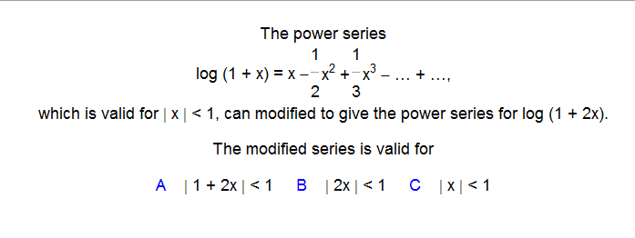

I've attached the question
I'm not exactly sure how to do this question. Is it an interval of convergence question where i simply let log(1+2x) < 1 and solve for x??

It's actually more of a logic problem. They told you log(1+x) converges for |x|<1. So what's the range of convergence of log(1+2x)? You are overthinking this by quite a bit.

No. What I would do is find the power series for log(1 + 2x), which is simply a matter of a substitution, and then determine the interval of convergence of the new series.

Your choice, of course. But I don't think you need any convergence tests to answer the question. x is a number, 2x is a number.
so your saying the answer is simply |2x| < 1?

Okay I understand how to do interval of convergences but how would I get the new series through substitution?
