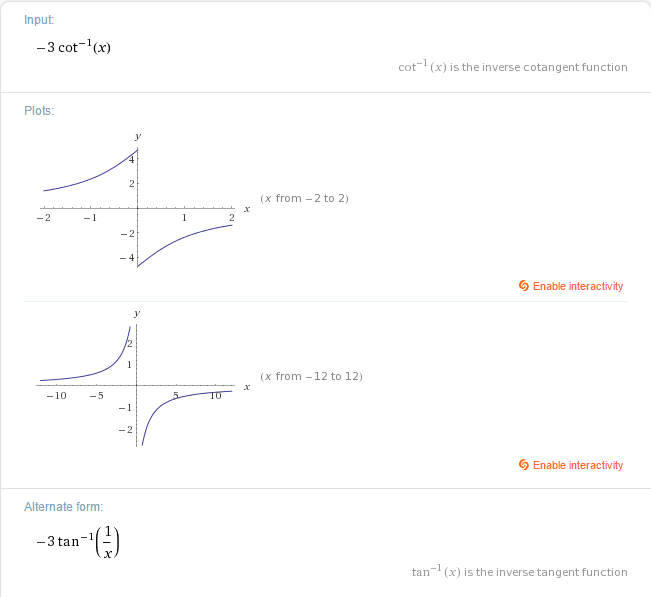

Find the regions of increase and decrease for ##f(x) = -3 \cot^{-1}(x)##
2. The attempt at a solution
My instructor and I disagree. The answer he gave was ##(-\infty, \infty)##, while my answer was ##(-\infty, 0) \cup (0, \infty)##.
My reasoning is this: ##-3\cot ^{-1}(x)## is not defined for ##x=0##. So, we cannot say what the behavior of the function is (increasing, decreasing, constant) at ##x=0##.
If my reasoning is wrong, I would like to understand why.

Actually, wait. I'm aware of what you're referring to, but the answer he provided was ##(-\infty, \infty)##. Clearly, that is not correct, as he is including ##0## in the interval.

Assuming your professor is using the standard definition for the principle value of the arccot function, which is the graph I showed you, I would say your answer is not completely correct. The arccot function is continuous at and decreasing at ##x=0##, and you have excluded that point. Of course, your problem has that -3 in front of the function so yours is increasing. In your first picture in post #3, if you moved the right half of the graph up until it connected with the left half, it would be correct.
[Edit, added:] By "correct", I mean qualitatively. I am referring to the continuity, not necessarily the vertical placement of the graph of your given function.

Even going with the version from WolframAlpha, it says there that the domain is ##(-\infty, \infty)## .
Hmm. That's so odd; why does the graph show a disconnect at ##x = 0## then?
There is a discontinuity, a jump discontinuity, but ##\ \cot^{-1}(0)=\pi/2\ ##.

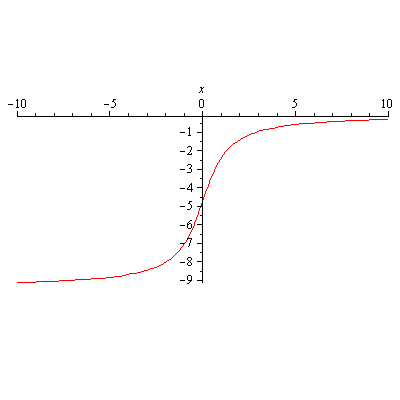

There is no discontinuity in the graph of ##-3\cot^{-1}x## if you use the standard principle value.

LCKurtz said:
There is no discontinuity in the graph of ##-3\cot^{-1}x## if you use the standard principle value.View attachment 98628
Could you (or anyone else who sees this) elaborate on the "standard principle value?" I don't understand how we can just shift the right-hand side up.

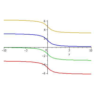

I'm going to ignore the -3 in your problem for now. Since the cotangent has many different segments that map onto the y axis, the "inverse" would be a multi-valued function. A partial graph of that is:
Plot of four horizontally shifted decreasing S-shaped curves over x from -10 to 10, in yellow, blue, green and red, with y-axis marked from -6 to 6.
If you want a single valued definition (that is, a function), you have pick what part of this graph to use. It doesn't matter which part is chosen as long as everyone knows which it is. That's why you need a standard choice. If you want the arccotangent to be continuous, the standard choice would be the blue one. Many texts choose this branch and then call it Arccot, with a capital A. With this choice, Arccot(x) is always an angle in ##(0,\pi)##.
An alternate, less common, choice is to choose the left part of the green and right part of the blue graphs, which would put the standard angle in ##(-\frac \pi 2, \frac \pi 2)##. This gives a jump at ##x=0##, but you still must choose either ##\frac \pi 2## or ##-\frac \pi 2## for its value at 0.
So, no matter which way you do it, it is incorrect to say arccot(0) is undefined. In any case, as I pointed out in post #4, it is apparent that your professor uses Arccot(x) as above as his standard one. So would I, and I would suggest you do so too. That being said, I think you should move on from this problem. I think you understand the issue and that's all that is needed.
