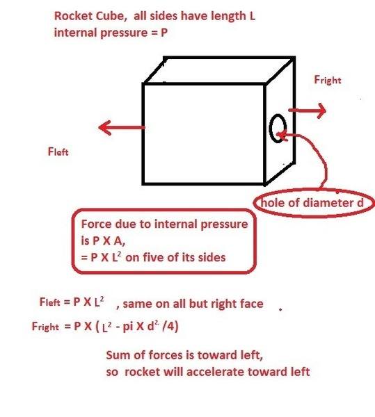

How I wish I were good with graphics.
Here is a simple thought experiment that will make it intuitive...
Imagine a very un-streamlined rocket out in space. With no atmosphere there it need not be streamlined, does it?
So in your mind make it a perfectly sealed and rigid cube one foot by one foot by one foot. (I use English units because I'm both old and in USA, use metric if you like and make it a 1 meter cube for same logic will apply).
Now internally pressurize your rocket to 1 PSI.
What are forces on each of the six sides? Clearly 144 pounds pushing outward on each side.
Since the cube is rigid, the forces on opposite sides cancel out so there is no net force on the rocket. Up cancels down, left cancels right and forward cancels backward.
Now open a 1 square inch hole(or valve) on any face - i'll pick the bottom.
This is a simple thought experiment so we'll ignore refinements that would be dictated by proper fluid mechanics - entrance losses and vena contracta and all that.
Bottom face of your cube is now only 143 square inches, but top face is still 144.
So forces are no longer balanced. 143 pounds push down against bottom, but 144 still push up against top.
So rocket will accelerate up.
So - a rocket in a vacuum accelerates not because of propellant pushing against air, but because of propellant NOT pushing against anything!
Last statement was shocking enough that I always remember this oversimplification.
Rocket scientists add converging-diverging nozzles to refine the fluid mechanics.
any help?Movie "October Sky" is a fun story about some youths interested in rocketry. It has interesting pictures of amateur rockets.old jim

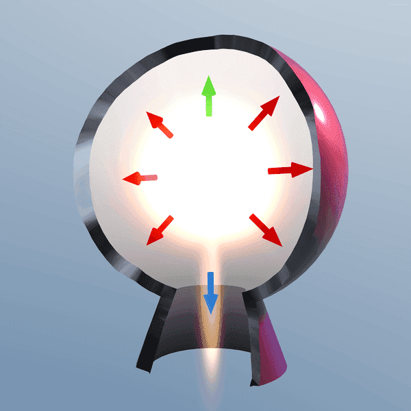

Here is what you probably mean:
https://en.wikipedia.org/wiki/Rocket_engine#Principle_of_operation

Here's an easier mental model. Sum of forces = MA .
Take an unstreamlined rocket.
Since you stipulated vacuum it needn't be sleek.
So, Let's make it a cube.
It's not where it pushes,
it's where it DOESN't push that counts.
Now any mechanical engineer will tell you that a converging-diverging nozzle will give more flow
so we would add a nozzle to our square edged orifice in that right hand face.
Any help ?old jim
