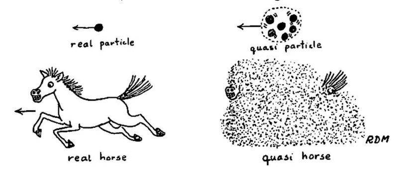

The notion of "quasiparticle" is not unique. There are two different meanings of that word in the literature.
Mattuck in the book "A Guide to Feynman Diagrams in the Many-Body Problem"
distinguishes quasiparticles from collective excitations. In his terminology, quasiparticle is an original individual particle together with a cloud of disturbed neighbors. For the sake of intuition, he compares it with a quasihorse, which is a running horse surrounded by the dust (see the picture below). On the other hand, a collective excitation (e.g. phonon) is not centered around an individual particle, so it's not a quasiparticle according to Mattuck.
In a large part of other literature, collective excitations (such as phonons) are considered as a kind of quasiparticles. Even though they are not localized in space, they are particle-like in the sense that they are described by the same mathematical formalism as "ordinary" quantum particles.
