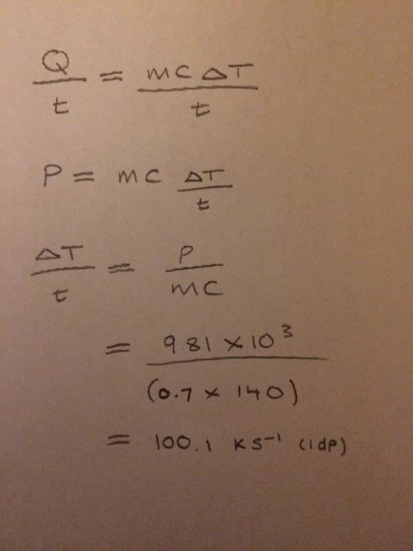

Q=m*c*deta t

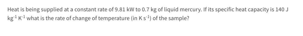

Question:
This would be the right approach to do this problem?
Thanks!

Correct approach. Incorrect result.
Why is it an incorrect result?
I think your answer is correct. I hope I'm not overlooking something trivial.
Three orders of magnitude too large.
Note that the power input is given in kilowatts.
TSny said:
in kilowatts.
..., and mass in kilograms.
Yes. From m and c you can see that it takes about 100 J to raise T by 1 K. Heat is going in at about 10,000 J each second. So T will increase about 100 K each second.
o:). Looking at the faint decimal point in "nine point eight one" and figuring he'd missed that in his computation; wasn't paying attention...100K/s? Intuitively offensive, but...o:)o:)
Yes. That rate of heating would not last long. :oldsmile:
