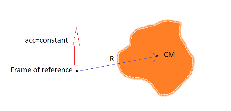

I am sorry. I think I failed to express my idea well. What I meant was that if we had an accelerating frame, whether the angular momentum of the orange body below would still be conserved (measured using the accelerating point). If not, what's wrong with my derivation?
Diagram of a irregular orange body with a labelled centre of mass CM, a blue line R from a frame of reference point to CM, and a red arrow labelled acc=constant pointing upward from the frame.
Just compute the AM for this case in the accelerating frame. Is it constant?
Well I don't know. If it satisfies ##\vec R\times M\ddot{\vec R}=\vec C'## then yes, otherwise no.

You seem to conflate frame of reference and point of reference (also in your picture). A frame of reference accelerates in a direction. A point accelerates along a line. But I think you have the right idea here.

In a accelerating frame one has fictitious forces. If the acceleration is linear, so is the fictitious force. The fictitious force applied to an object is given by the mass of the object times the acceleration of the frame.
Corresponding to the fictitious force is a fictitious torque. The moment arm of the fictitious torque on an object is given by the offset of the position of the center of mass of the object from the reference axis in a direction perpendicular to the acceleration of the frame.
If the acceleration is non-zero, and the mass of the object is non-zero and the offset of the object's center of mass from the reference axis is non-zero then angular momentum will not be constant. It will not be conserved.
If, instead, one is thinking in terms of acceleration shifting perspective from one inertial reference frame to another inertial frame that is infinitesimally different then one might prefer to say that the angular momentum is not the same in the two frames. It is not invariant.
In this case it is two words and two different ways of looking at the same thing.
