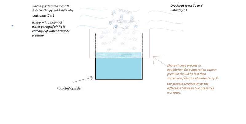

for heat to flow from hot to cold body there should be driving force which is temp difference..
but evaporation is case of mass transfer..in which driving force is difference between the vapor pressure and saturation pressure of water at that temp. As the difference increases evaporation increases and finally comes to an equilibrium state when two pressure become equal.
Clausius statement is that no heat can be transferred from cold to hot until work is done.
work is done to create the driving force( temp difference). here when air whose relative humidity is less then 100% comes,it swept away vapors with it from liquid surface thus lowering the vapor pressure and creating a driving force.
in the fig,cylinder is insulated from sides.when vapor pressure decreases,molecules at surface of water extract energy from neighboring molecules and become vapors,thus lowering the over all energy content of liquid water(temp).
according to clasius statement there must be work, where is work?
That has already been explained:
mfb said:
In addition, you transfer a lot of energy from a very hot system (the sun) to a cold system (anything on earth).
This is a distortion of Clasius' statement. His statement was "Heat can never pass from a colder to a warmer body without some other change, connected therewith, occurring at the same time." See p 117 here. Evaporation is "some other change, connected therewith".
