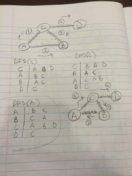

Hello, I drew up this graph to try and understand the concept of depth-first search. Starting at node C, I was wondering if its correct for the order to be C-A-B-D or C-B-A-D? It seems like you can traverse in either direction without a problem.
For me, both are valid. You could certainly look at all the children, order them by some preference and visit each one in that order.
I'm confused as to what movements are not allowed? It seems very unclear to me what is a legitimate traversal and what isn't. Can you go C-D-B-A or C-D-A-B? What counts as not being permitted?
Depth-first means the whole subtree of each child node is processed before any other child nodes are processed. Does that make sense? Your example tree is a bad example because the children of C have no children themselves.
Oh sorry, you are talking about a graph, not a tree. Hmm.
Ok, for a graph, depth-first must mean, process every unvisited neighbor before backtracking. CAD -- not allowed.
