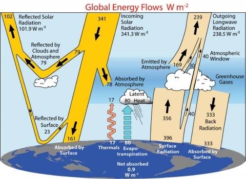

The Earth's effective temperature of 255K is reached at approximately 16,000' above the surface on average. By raising this level, we effectively increase the temperature at all lower levels at the environmental lapse rate, ie. 6.5 deg C/1000 meters (3.6 deg F/1000 feet). This involves no vertical air motion, no loss or gain of energy across a boundary. It is solely the result of changing air pressure with changing altitude and is on average what you would experience if you ascended in a hot air balloon through dry air (relative humidity less than 100%).
Not to nitpick, but the Earth's surface is the source of energy warming the atmosphere. The source of your body heat is the food you eat. That this can all be traced back to an origin at the core of the Sun is in fact true, but not really relevant as to why your body or the surface radiates infrared. In the context of global warming, a warmer sea surface is a prerequisite to a warmer atmosphere since it is the surface that for the most part warms the atmosphere. However if the sea surface is not first warmed by increased solar irradiance, the slightly greenhouse gas warmed lower atmosphere must be warming the water as it exchanges energy with it tending toward thermal equilibrium, everything else remaining equal.
  • #50
Correct. More or less greenhouse effect is a shift in the equilibrium. No matter how how or how high or low the effective radiating level, no matter what the mean surface temperature, there is still a balance of energy at equilibrium.
Yes. That is what I have said also, consistently in all discussions of the greenhouse effect.
The present equilibrium is roughly as follows (rounding some figures a bit):
  • 170 W/m^2 from space absorbed at the surface.
  • 65 W/m^2 from space absorbed into the atmosphere.
  • 40 W/m^2 from the surface direct out into space. (The infrared window.)
  • 450 W/m^2 from the surface up into the atmosphere. (Special heat 100 and radiant heat 350.)
  • 320 W/m^2 from the atmosphere back to the surface (backradiation).
  • 195 W/m^2 from the atmosphere back out to space (atmospheric emissions).
If you add up those figures, you'll see there's energy balance at surface, atmosphere and space. The total flux in from space is 235, which is equal to the total flux out into space.
You can also check the net flow between any two of surface, atmosphere and space. It is:
  • Net flow from space to surface = 130 (170-40)
  • Net flow from surface to atmosphere = 130 (450-320)
  • Net flow from atmosphere to space = 130 (195-65)
Roughly speaking, if you increase greenhouse absorption you increase surface temperature and surface radiation. Suppose the surface radiation increases by a factor of 10%. (That's a large increase as temperature, about 7 degrees.) Assuming atmospheric absorption of solar input is unchanged, and albedo is unchanged, there's no change to the flows out of space. The flow direct from surface to space becomes 44. This means the flow from the atmosphere to space will be less, at 194. The net flow from space to surface becomes 126. (Being hotter, the surface is radiating more effectively.)
The flow up from the surface will increase, but not by 10%, because some of that flow is special heat, which should stay roughly the same to a first order approximation. Suppose we have 100 as the special heat, then the 10% increase applied to the remaining 350. That is, the total flow from surface to atmosphere increases from 450 up to 485. Because the atmosphere is in balance, the backradiation increases to 485+65-191 = 359.
In the new equilibrium state, you still have energy balance. All the input ultimately comes from space, and it is balanced by the longwave emissions. The difference between the radiant energy in and the radiant energy out at the bottom of the atmosphere is 350-320 = 30 in the original equilibrium. In the new equilibrium it reduced to 385-359 = 26.
Exactly. A stronger greenhouse effect results in a warmer surface, which also results in a warmer atmosphere... at least, for altitudes below the effective radiating level!

I don't know what you are quoting here, but the various transports can be quantified quite nicely. There are uncertainties, but there is more than enough to establish that actually, convection is the smallest part of heat transport into the atmosphere from the surface.
If we take global averages, over all latitudes, and seasons, and times of day, the net transports work out to about
  • Convection: around 17 W/m2. Accuracy not particularly good, but it's around this magnitude.
  • Latent heat: around 80 W/m2. Accuracy here is pretty strong; it follows directly from annual precipitation. This is the heat of evaporation which is released into the upper atmosphere as water condenses.
  • Radiant heat: around 63 W/m2. Accuracy here is fair; enough to be confident that its rather less than the latent heat, and a lot more than the convection.
These fluxes vary enormously from day to night, of course; the numbers are mean values for the net contribution to transfer of energy from the surface up into the atmosphere.
The radiant heat numbers are confounded somewhat by the fact that it is actually measuring the difference between two very large flows of energy. There's something like 396 W/m2 being radiated up into the atmosphere from the surface, and then about 333 W/m2 being radiated back down again. These values are probably all good to within a couple of W/m2, or 3 at the outside. Convection thus has the largest proportional uncertainty, but in absolute value they are all reasonably well constrained by empirical observations.
The basic idea of the greenhouse effect has been known for well over 100 years. I've recently been reading the work of John Tyndall, in about 1860, where he first discovered the importance of how different gases respond very differently to heat radiation. He describes how this effect results in the Earth's surface being maintained at a much warmer temperature than otherwise. Science has gone a long way since then, to quantify and understand much better how light interacts with matter.
Basic recognition that certain gases -- especially H2O and CO2 -- trap heat by strong interaction with thermal radiation is about as solid as anything in science can get.
More recent discussions of these questions can be found as follows:
  • More on Tyndall's experiments, with links at [post=2187943]msg #10[/post] of "Need Help: Can You Model CO2 as a Greenhouse Gas (Or is This Just Wishful Thinking?)"
  • Diagram of the various heat fluxes, with references, at [thread=307685]msg #1 of Estimating the impact of CO2 on global mean temperature[/thread].
Cheers -- sylas
