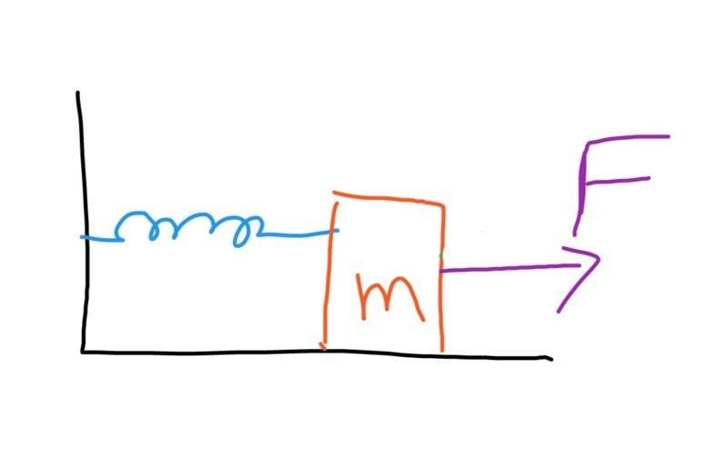

Is it necessary that the applied force F is equal to the spring force 'kx'?
Are you trying to invoke Newton's 2nd law or Newton's 3rd law? What, if anything, do either have to say about the situation?
I am not trying to invoke any law
No
sophiecentaur said:
Is the mass stationary?
The way you've drawn the picture, it looks like F is a separate force applied to the mass, not the spring force. You'll have to tell us what the drawing means - you drew it! (presumably).
navneet9431 said:
No
Make the spring as weak as you like. Would F be zero?
Yes,F(on right) is a separate force applied to mass m other than the spring force acting on the left side.
Please write down for us your Newton's 2d law force balance equation on the mass M.
F-kx=ma
navneet9431 said:
F-kx=ma
Perfect. Does that answer your question?
In that case it can have literally any value you choose to give it.
So it means that F=/=kx
But is it possible that F=kx in any condition?
If the mass is stationary, or if F is applied in such a way that the mass is moving at a constant velocity. Look at the equation you wrote. What is "a" under these two situations?
Zz.
Thanks
Zz.
YOU will choose that.
If you choose |F|>|kx|, then m won't be at rest, but will have a constant acceleration rightwards.
If |F| = |kx|, then you have achieved an equilibrium, nothing moves. (In lab, this is how we calculate spring constant, where F=mg:biggrin:)
If |F| < |kx|, then you will have the spring pulling m leftwards.
