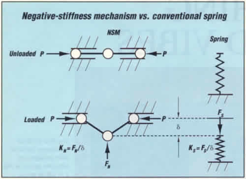

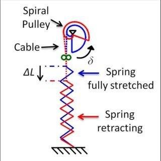

You could use a mechanism to make the spring (or any other elastic source of force) output more linear regarding force and work.
However, it is not achievable for power, I believe, because the output speed (linear or rotational) will always suffer, even when the force or torque could be kept more or less constant.
You could however, accumulate the potential energy of the work done by the spring, in order to used later at constant power.
Let's say, your spring pumps water into a reservoir for later use in a turbine.
Diagram of a spiral pulley with a cable wound around it, connected to a vertical spring hanging from a fixed hatched support at the bottom; labels read Spiral Pulley, Cable, ΔL, spring fully stretched, spring retracting, and an arrow marked δ.
Diagram titled Negative-stiffness mechanism vs. conventional spring, comparing an NSM with two pinned side supports and a centre node under unloaded P and loaded states against a standard zigzag spring fixed at both ends, with K_N = F_N/δ and K_S = F_S/δ labelled.
Sounds physically OK, but dodges math problem.
In engineering, I think, it needs flywheel and feedback to make it work, unlike Jack's solution without temporary energy buffering and recovering by feedback loop.
Engineering Jack's solution is not easy too, it may need computer assistance to accurately control retardation for the calculated real time displacement.
