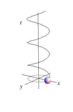

The point is that while in the 3D space particle can be at rest or follow some trajectory, in the spacetime it is not so. The very fact that particle's own clocks (i.e. those at rest w.r.t. the particle) always measure particle's proper time implies that we have to replace the notion of trajectory in space by a worldline in spacetime. Let me illustrate it on a simple picture (I drew it without tooo much care, sorry for the quality)
Suppose that in 3D some particle is moving along the circle. Circle is the trajectory of the particle in space. In the figure shown the particle orbits in the ##(x,y)##plane, the axis ##z## is suppressed. At the beginning, the time is ##t=0## and we mark this in the spacetime by a point (in my figure a ball) with coordinates
##(t,x,y)=(0,r,0)##
where ##r## is the radius of the circle.
At later time ##t>0## particle is already shifted along the circle by some angle. But now we must mark the position in spacetime at the point lying at different slice of the spacetime, i.e. lying at the slice corresponding to given time ##t## - it will lie above the plane where the ball is plotted and the coordinates are
##(t,x,y)=(t,r\cos\omega\,t,r\,\sin\omega\,t)##
where ##\omega## is the (angular) frequency of the motion of the particle.
To conclude:
  1. Event is not a point in space, but in a spacetime and carries the information about the position of the particle but also about the time it happened.​
  2. As the particle orbits with velocity vv (in fact, v=ωrv=ωr), in space, each position of the particle is represented in spacetime by an event lying at different time slice of the spacetime.​
  3. All events (tt, position at time tt) together form a curve n spacetime called worldline.
  4. Trajectory of our paticle is a closed circle, while its worldline is an infinitely long curve (called helix in this case, somewhat different kind of a spiral). Trajectory is depicted in my figure by a dashed circle, the worldline is the solid line.​
  5. Although trajectory can be also a single point in space (if the particle is at rest), it must always move in the time direction in spacetime (upwards). In the case when the partice is at rest or moves with constant velocity, its worldline will be a straight line in spacetime but a single point in space.​

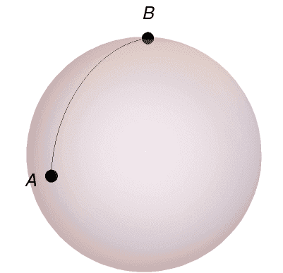

I know this is quite trivial but I am slowly getting to my point regarding gravity. What I wanted to emphasize is that in spacetime particle always moves along the worldline. In fact, in some sense the speed of any object in spacetime is always equal to the speed of light. I will not explain this issue now because I don't want to digress even more, I can explain on request.
If we have just space with particles which do not interact in any way (electromagnetically or gravitationally), the worldlines of particles will be simply straight lines whose slopes will be given by the velocities of particles. These velocities will not change, because there are no forces and hence no interactions. So, the helical motion depicted in the figure above cannot occur if there is no interaction. But you can imagine that our ball from the figure is, say, the Earth and in the center of the circle is the Sun which attract the Earth through gravitational force and therefore it curves the trajectory and, consequently, the worldline of the Earth.
Nevertheless, without interaction, particles follow straight worldlines. In usual spatial geometry the line from AA to BB is the shortest path connecting points AA and ##B##. In spacetime geometry, on the contrary, it is the longest path. Have a look at the spacetime interval ds2ds2 given above. Unlike the Pythagorean theorem, coordinates and time enter with opposite signs, that's the reason for this unusual feature of spacetime geometry. Although it is important, in what follows I will not discuss whether line is shortes or longest distance and I will simply call it extremal (either minimum or maximum) like it is usual in mathematics.
In order to introduce more convenient terminology, we call an extremal worldline connecting points AA and BB a geodesic. Geodesic is "as straight curve" as possible. In special relativity the geodesics are really straight lines. But imagine a surface of a sphere (ball) and choose two points. What is the shortest curve connecting them? It is certainly not a line because such a line would lie inside the sphere, not on its surface:
The shortest path connecting AA and ##B## is in fact an arc lying on the surface:
This arc is one of geodesics on the sphere. Whether the geodesic is the shortest or longest path depends on the actual geometry.

At the layman level, I'd suggest starting to learn about non-flat geometries by studying spherical trignometry. A general treatment of curvature in n dimensions is just too hard to describe at a layman level, but some insight can be gained by studying the simplest cases.
