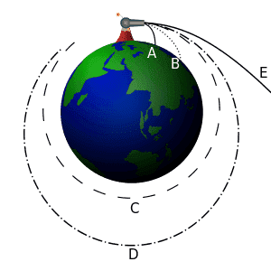

I think I might have heard something along these lines. Does it have anything to do with this?
Good ol' Newton
Perhaps when it says large, it really means large

Kaimyn said:
I think I might have heard something along these lines. Does it have anything to do with this? …
ah! thanks Kaimyn! … the ol' do-it-from-the-top-of-Mount-Everest trick! :biggrin:
in that case, Cheddar, you can forget about gravity …
the gun, and the acceleration, will be horizontal (and the mass will be supported by the bottom of the barrel of the gun :wink:).
