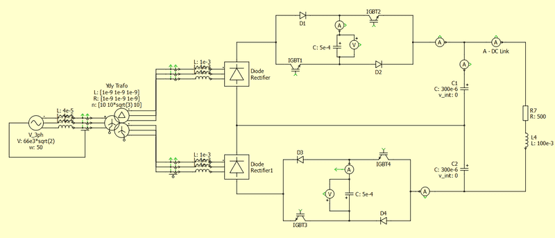

What I have, is a common 12-pulse rectifier with its bridges in series and I included an snubber between DC-link and rectifier output. Is important to note that all inductances before the rectifier are small in order to minimize its impact on this snubber performance. Also, I cleaned the circuit from scopes and control of IGBTs in order to visualize in a better way this system.
Simulation schematic of a 12-pulse diode rectifier feeding a DC link with two IGBT-and-capacitor snubber branches, one in each bridge, and an R-L load on the DC side.
The main Idea of this snubber is to give a semi-triangular shape to the current by following a reference (each snubber has it reference which is the same shape but shifted in 30°). The background theory and reason for obtaining this currents, is that doing so, I should have sinusoidal currents at the transformer's primary winding or the AC busbar which is connected this rectifier.

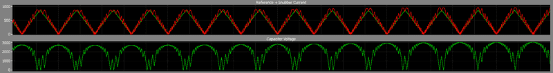

Now, the snubber is supposed to work like this: If output current from snubber is greater than reference, then IGBTs must be turned OFF in order to charge this capacitor and lower output current. Otherwise, if output current is less than reference IGBTs must be turned on, discharging this capacitor and increasing this current. Until now, I can only get this working using DC voltage sources instead of rectifiers (250kV each bridge) as you can see in this picture:
Two stacked time-domain plots: top, a reference (green) and snubber current (red) oscillating between about 0 and 1000 with a semi-triangular shape; bottom, capacitor voltage (green) with arch-shaped pulses up to about 3000.

Here the tracking of the reference (green) is really great but for some reason the voltage across the capacitor increases until my simulation crashes. The main idea of this snubber is to turn off both IGBTs when voltage across capacitor is aprox 1V in order to reduce losses while switching, however, if I add that condition in both cases (with DC Voltage Sources and 12-pulse rectifier) the output current from snubber (red) takes a long time to discharge when the snubber have to track the lower sections of this triangular reference.
Any suggestion or recommendation would be truly appreciated as I don't really know what to do instead of changing values of my system without knowing why.

Both rectifiers. I call 'snubber' that IGBT+DIODE+CAP configuration (D1, D2, IGBT1, IGBT2 and C). The DC Link will be a +/- link at the right of those 300uF cap in a way that the AC component of this "triangular current" circulates through 'Diode Rectifier', 'Snubber 1' and C1.

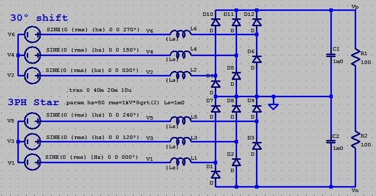

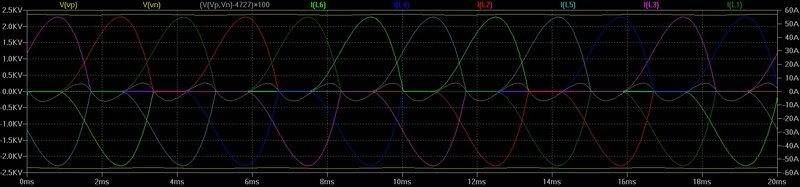

When fed from a 3PH supply and another shifted 30 deg by a zig-zag transformer, the output ripple is only about 6 volts in 4727.V, and the current is likewise remarkably stable. I see no reason for the IGBTs.
The output of full-wave rectified 3PH star is the same as a full-wave rectified 60° shifted delta. That will not cancel when the two are added in series.
Maybe your simulation used the 60° phase shift of a delta connected transformer, rather than the 30° phase shift of a zig-zag transformer.
