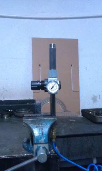

For an experiment, I sent specific pressures of air strams through a tube and I was wondering if there was a way to calculate the speed of the air since I know the pressure and the radius of the tube where it left from.

The tube which the air was sent through is approximately 25 cms long. One end is closed and is where the air constantly flows in, at a constant pressure, this is unknown. A valve allows me to control how much air is put into the 25 cm long tube. By covering the exit, I can build up pressure and read it off of a barometer.

I don't stop adding air, the air is still flowing into the tube at the same rate. I attached a picture of the system, The little blue pipe is constantly blowing air into the tube at the same velocity/pressure. You can see the barometer and the valve right next to it, The valve allows me to control how much air I let into the main Tube. Than I cover the exit, read the barometer to see how much pressure builds up in the tube, than I let the air flow again, and I want to find out how fast the air moves when it's leaving the tube. The main blue pipe is still supplying air at this point.
